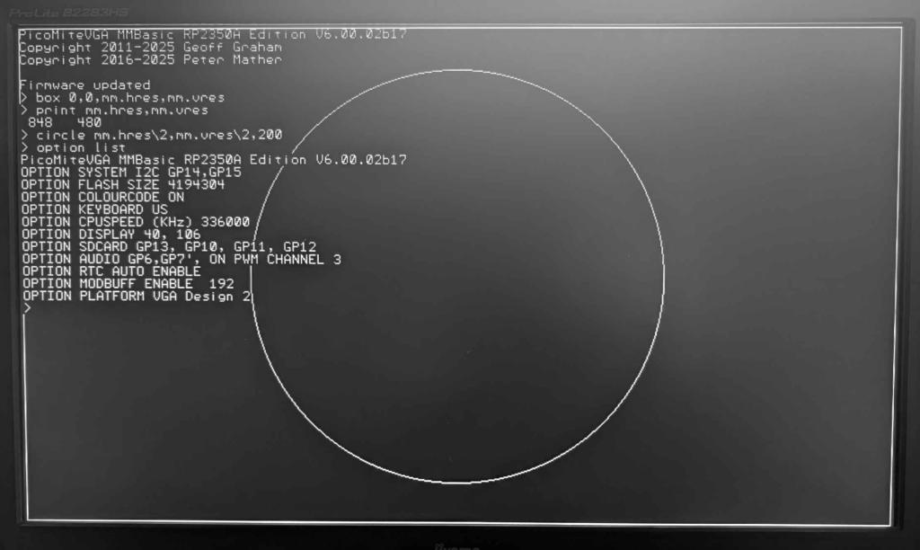

Install the firmware. Type OPTION CPUSPEED 336000. This will switch to 848x480 mode (mode 10 from the CMM2). i.e. true widescreen. You may need to auto-adjust the monitor. Write a box BOX 0,0,MM.HRES,MM.VRES and then do the adjustment.
Please report success or otherwise

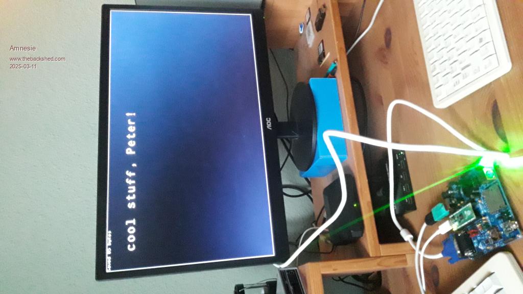

Amnesie
Joined: 30/06/2020
Posts: 763
Posted: 03:38pm 10 Mar 2025
Works perfectly! What a great option to have widescreen!
Greetings

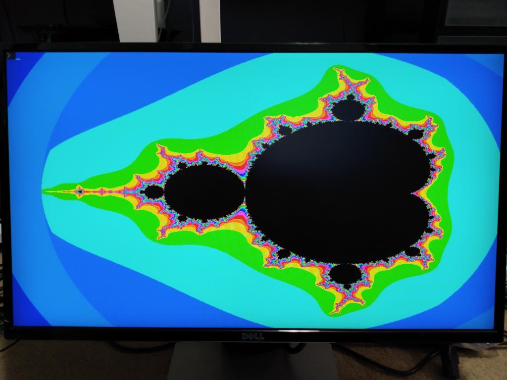

Sasquatch
Joined: 08/05/2020
Posts: 385
Posted: 09:49pm 11 Mar 2025
RP2350 VGA WIDESCREEN MODE 3 (848x480) on a 24" (61cm) Dell Widescreen monitor.

Amnesie
Joined: 30/06/2020
Posts: 763
Posted: 11:44pm 11 Mar 2025
Woah! This looks amazing!
Really really useful those new resolutions, since there are less 4:3 nowadays...
