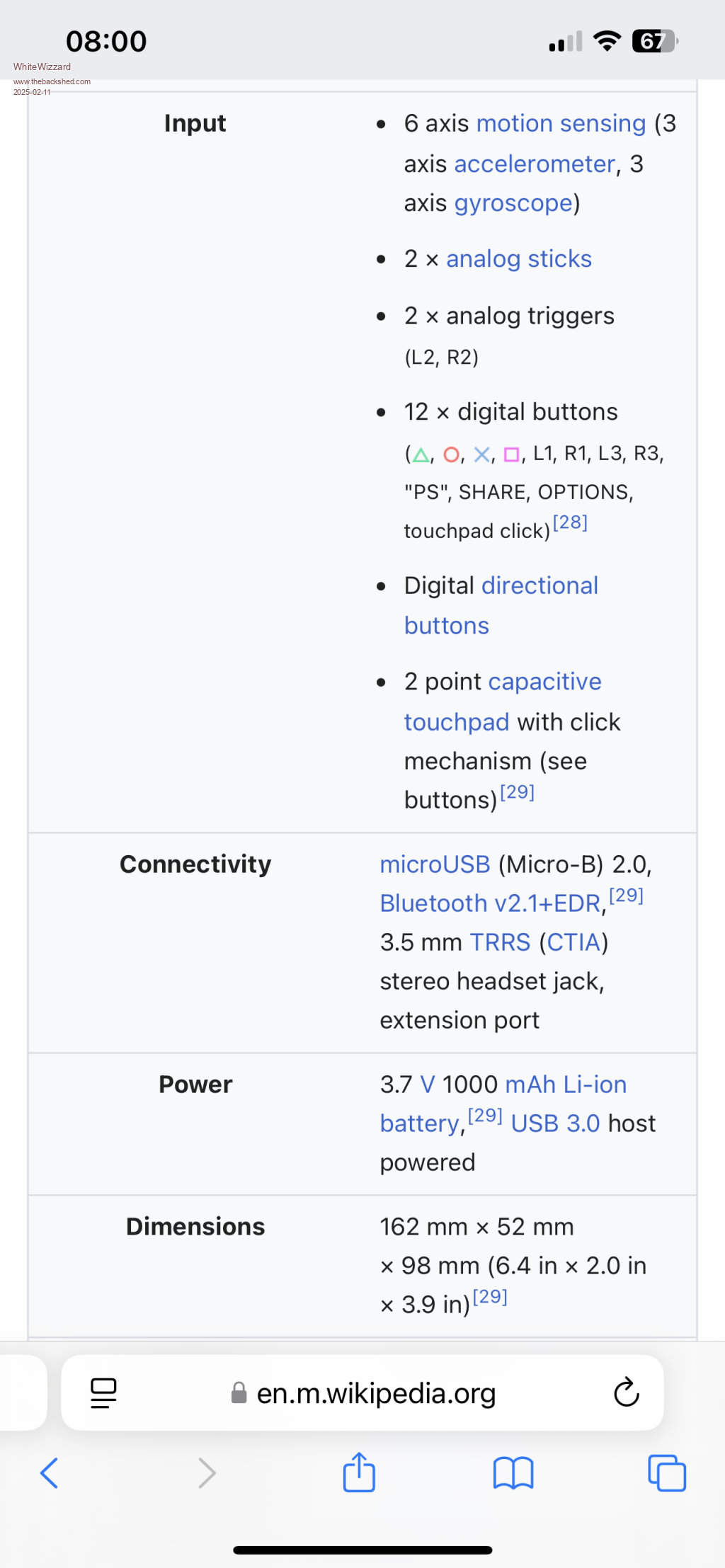

You are correct in that it has Bluetooth connectivity, but also in the specs it mentions microUSB too (possibly via a dongle?).

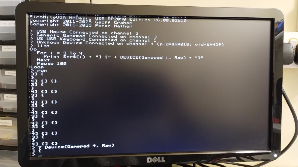

I'm away from home at the moment and don't have all my toys. In B10 there is a new function DEVICE(GAMEPAD n,RAW)
This returns a string containing the raw data returned in the USB report. For most controllers this will be 8 bytes long. Please could you have a look at this with your Buffalo and see if it works. The firmware polls the controller every 20 milliseconds so this value will update at that frequency.
Posts: 4405
Posted: 11:07am 11 Feb 2025
Thanks Peter,
But unless I was misunderstanding your instructions something looks borked:
Note that I think the "Generic Gamepad" reported on channel 3 is a "hallucination" that having the keyboard attached is producing.
Edited 2025-02-11 21:15 by thwill
Posts: 12042
Posted: 11:34am 11 Feb 2025
Its binary data
Posts: 4405
Posted: 11:40am 11 Feb 2025
  matherp said  Its binary data
Ah, I thought it would be hex encoded ... I'll deal with it ;-)

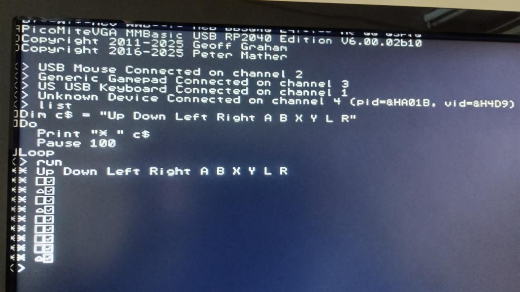

Posts: 4405
Posted: 12:14pm 11 Feb 2025
Sorry Peter, but unless I'm having some sort of psychotic break there is something both a bit "fu" and also more than little bit "bar" in this firmware:
Something is tramping over c$

Posts: 12042
Posted: 12:31pm 11 Feb 2025
OK I think I understand. I'll post an updated test version for you VGAUSB RP20240?
