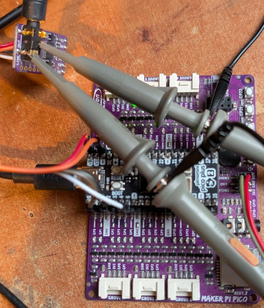

I said I wouldn't but then it looked like an interesting challenge
RP2350 only - uses PIO2

OPTION AUDIO I2S BCLKpin, DATApin
This reserves BCLKpin and BCLKpin+1 for the bit clock and word clock and Datapin for the I2S data. It requires an I2S DAC that can PLL the bitclock to create its own master clock
For example:
OPTION AUDIO I2S GP1,GP5
GP1 is the bit clock
GP2 is the word clock
GP5 is the data pin
All normal audio should work TONE, MP3, FLAC, WAV, MOD, SOUND
Note that you will see jitter on the BCLK. For the CPU at 150MHz the PIO needs to run at 44100*128 = 5644800 = 1/26.57 of the CPU clock speed. The way the H/W does this is to add or subtract clock ticks to the length of the PIO clock to give an average of 26.57 CPU ticks per PIO clock - hence jitter.

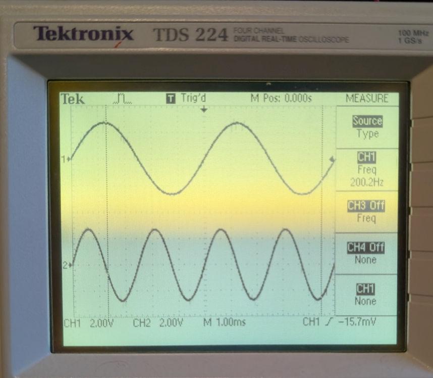

PLAY TONE 200,400
