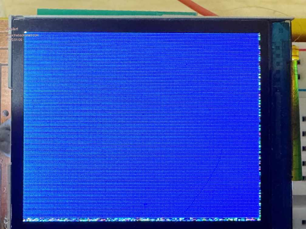

Have a small offset problem with East Rising 1.8" 160x128 LCD, model ER-TFT018-3 with st7735s SPI controller. I've used OPTION LCDPANEL ST7735 etc in the setup.
This is the screen I'm getting with 2 examples of the LCD I've tried:
The white dot in top left corner was achieved with PIXEL 1,2
Has anyone else experienced this and if so figured a fix?

Hi
I had a similar issue with the Waveshare Pico-LCD-1.8
Fixed it with
Poke Display HRES 161
Poke Display VRES 130
/Lasse

Thanks Lasse, did the trick :)
