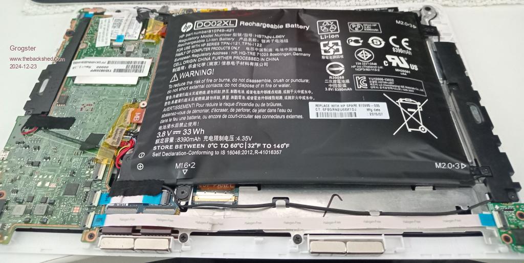

This is not good......
At least it was easy to get apart - the battery had pretty much popped most of the clips holding it together!
This unit WILL NOT power-up now, with the battery removed.
Could it be possible that they design a tablet, such that WITHOUT the battery being present, it won't boot?
Hmmmmmmm......

No boot without battery seems common, might be able to get around that.
The battery would have been flat back in 2015.
Cheers Aaron

I guess you could try several 18650 cells in parallel to see if it runs ok with them instead. If so they would need to be externally mounted.
If you don't have any of them simulate a battery with a power supply set to 4.35V, perhaps with a dummy load to absorb any charging current if it needs it own PSU plugged in for the first boot.

A big capacitor for a battery then run it from external supply.
The poota probably thinks the battery is flat and is waiting for some charge in it before turning on.

Certainly worth a try, though as the cap will start with 0V it may assume its a failed battery and refuse to charge at all.
Maybe a little DC to DC converter set to 4V connected between the power socket and the capacitor may fool it.

try removing the cell(s), but retain the electronics PCB (the BMS). connect an 18650 up to the BMS and see what happens.
is it an HP X360? i have a number of HP Stream 11 G3 machines that use 2 cells in the base - underneath the keyboard. i have run these with the battery (including BMS) unplugged without issue. the machine i am typing this on in fact has no battery installed and the charger plug permanently taped in place. i've also experimented with powering the machines with 2 banks of 3x paralleled 18650 cells; with the stream 11 you can replace the cells without the BMS getting unhappy.

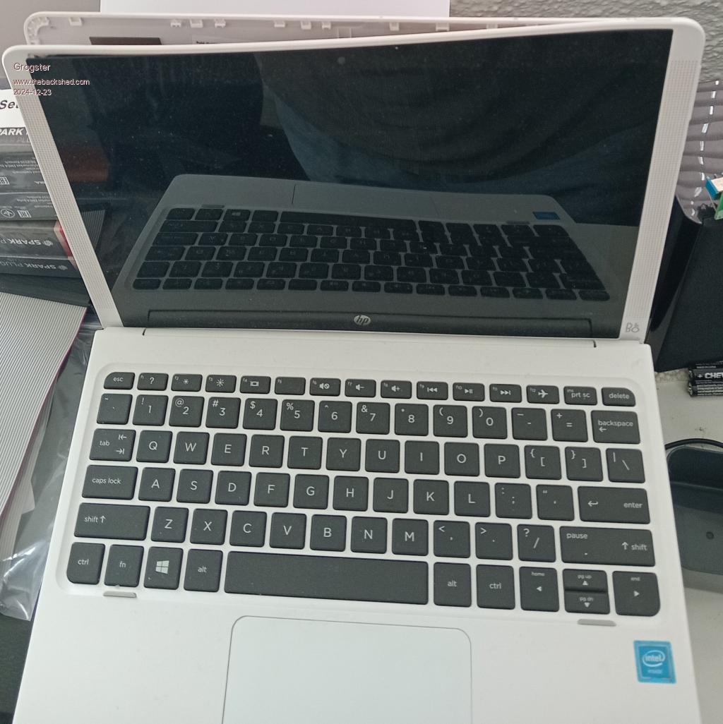

HP have cryptic part numbers on their machines, that DON'T match what the bloody thing is actually referred to.
Product: P6M73PA#ABG
The keyboard is removable, turning it into a tablet, or you can put the keyboard on to turn it into a netbook kind of idea.
A search of Mr. Google reveals that this thing is a "HP Pavilion x2 - 10-n103tu" - why the hell the product code and the product name don't match, is beyond me, but HP are notorious for for this kind of thing.
The label on the unit mentions that "10-n103tu" is the "M/M", but most people would try(just like me) to find it using the PRODUCT CODE.  Nowhere on the product spec label or the machine itself, does it even MENTION it is a "Pavilion X2" - you only find that out, after searching the product code.  WHY, HP, WHY?!!!?!?!!
Starting to rant now, so I'll stop.
It's a quite low-spec thing, so I don't know if it's worth fixing it or not.
I suppose it would work fine with something like Puppy Linux on it and a simple terminal software, it could still be useful I guess.  It is small and light, so maybe....
