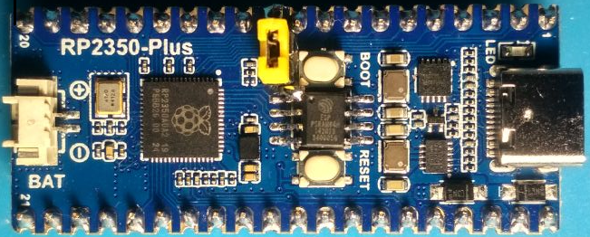

  lizby said  Exactly which PCB is this?
For example, in my experiments with PSRAM I use a Chinese clone of Pico2 called RP2350-Plus to which I soldered the PSRAM chip on top of the flash memory chip.
To select the PSRAM chip, one port of Pico2 is used, in my case it is GP8.
Edited 2024-12-22 11:03 by javavi

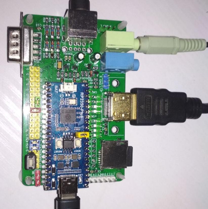

The board that carries the RP2350 looks nice. What is this..got a link?
This board is the so-called Murmulator 2.0
The second version, unlike the first versions of Murmulators, is still in the development stage. The purpose of redesigning the circuit was to create a Pico2 on the RP2350A with HDMI support.
PicoMite HDMI works great on this board, including PWM sound, PS/2 keyboard and mouse, SD card, and it is also possible to connect an external USB Hub.
Murmulator boards are an inexpensive solution for credit card-sized development boards for creating retro console emulators on the RPi Pico.
There are many emulator firmwares, but only for Murmulator 1.x.
For Murmulator 2.0, I think there is only ZX-Spectrum at the moment, but this is just the beginning of the promotion.
I don’t know if it is permissible to open a topic on this board here on the forum?
If you are interested, write me a personal message.
