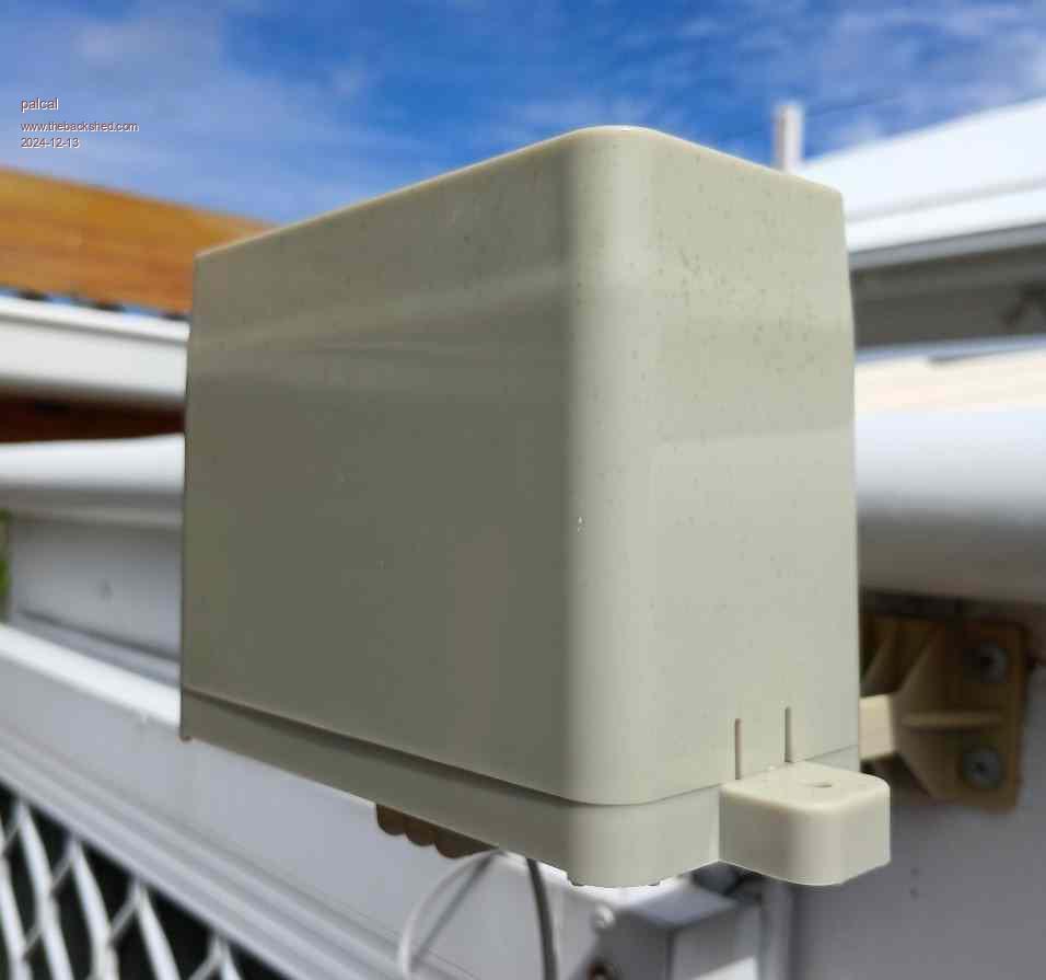

Any one using one of these rain gauges ?   Could you tell me what calibration value you use. I set this up some time ago but haven't had much rain till now. I was using 0.31mm per tip but it read 59mm for 52mm of rain so I figure the correct value to be more like .27mm per tip.

Oops the picture did not load.
Tried again but it won't upload.

Edit. Just saw your piccie. Bit slow typing. Probably not much help then...

I calculated the catching surface area of the rain gauge and did a similar thing with a known amount of water and that is where I got the figure of .31mm. but it doesn't seem to be accurate.

It looks like one I had. If so about .28mm is what I used.
The best way to calibrate it is with a 'real' old fashioned one close by.
Bunnings have a few to choose from.
You will find that one will read higher when it's windy and the other one will like calm steady rain.
I have 3 different gauges and they agree 'some of the time'.

Thanks Mick, I'm just using the switch in the rain gauge to count on a Picomite. I had it calibrated ok to read the same as my tube gauge but recently we had 52mm. overnight and it read 59mm. I'll just calibrate to the tube gauge again.

I am not sure where you have the tube gauge but looking at the photo of the tipping bucket, you will get lots of splatter from the roof with heavy rain. That will give higher readings.
I would wait for a range of comparisons before I re-calibrated.

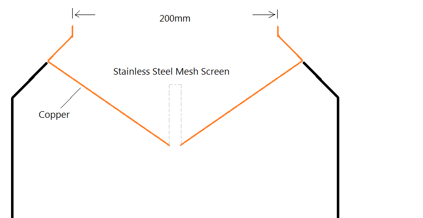

Yarra Valley Water have an "official" gauge here on top of the Divide. It has a copper funnel to prevent gunk growing in it and a very fine stainless steel screen to keep everything, including spiders out of the works. The inverted lip is a splash catcher to minimize losses in heavy rain. The slope of the housing prevents rain splashing in. The vertical rim is fairly sharp to split large drops for maximum accuracy.
It's a lot of trouble to go to given that, as observed by Jim, just a few tens of metres away the reading could be different.
At our fire station there is an automated weather station attached to the hose drying tower. The tower is an excellent roost for flocks of galahs, corellas and sulphur crested cockies so the rain gauge is almost useless. If there is stuff stuck in the buckets it reads too high, if the funnel is blocked, not at all. Cleaning isn't an option, its too high up and above a barbed wire anti-climbing fence.
So we use an old fashioned manual gauge.

@ Jim,  I moved the gauge this morning, higher up,  on to the timber you can see top left of photo where it wont get any splash. I hadn't thought of the splash effect, I just moved it to what I thought was a better position.
