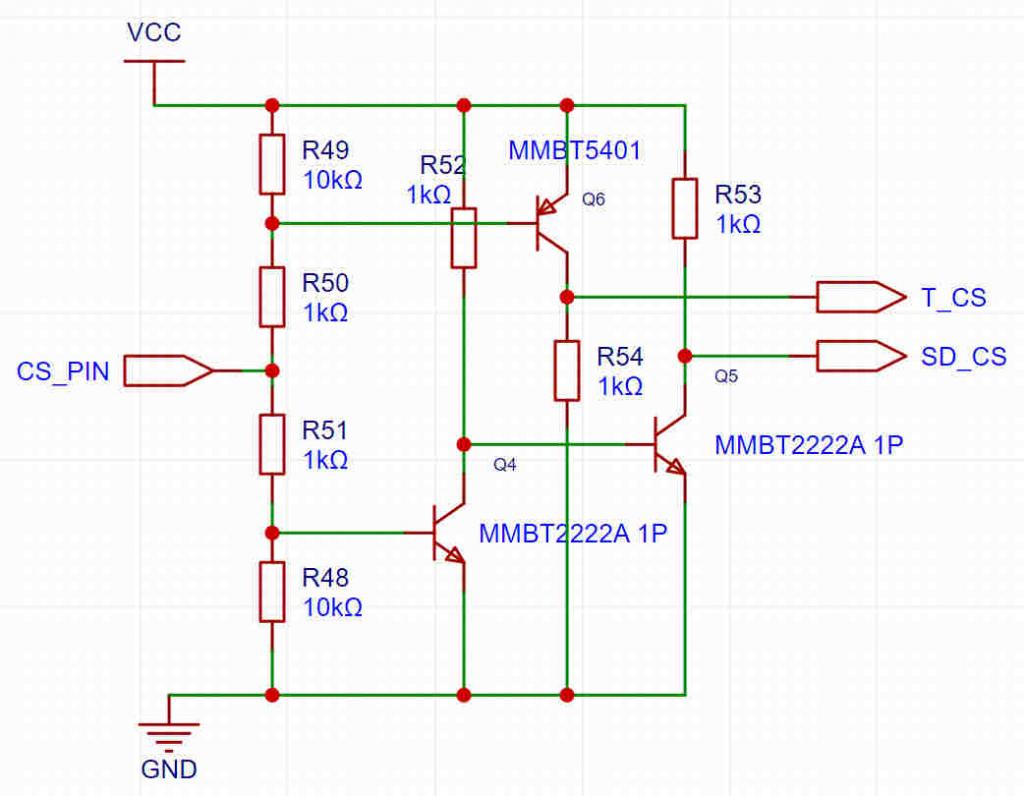

page 41: "OPTION LCDPANEL CONSOLE [font [, fc [, bc [, blight]]] [,NOSCROLL]". Parameter noscroll is not explained. This option is not listed in section options
page 56: I think mouse support is only available with vga/hdmi. At least it does not work for me with latest PicoMiteUSBRP2040V6.00.01RC3 neither in a terminal session nor on a lcdpanel as console.
page 91: option combined cs. The electric scheme which is necessary should be included in the manual somewhere. I might have overlooked it.

Circuit for OPTION COMBINED CS  is
