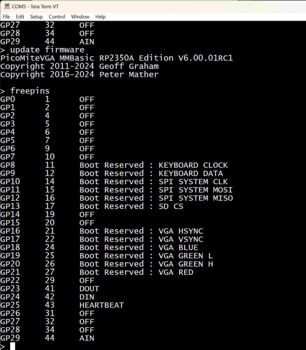

Posted: 05:41pm 26 Nov 2024
I suppose you mean something like this

  matherp said  I suppose you mean something like this
Yes! PicoMite's built-in procedure for informing about port status and reservations will be very useful for users/developers.
Edited 2024-11-27 04:00 by javavi
Posts: 6190
Posted: 06:52pm 26 Nov 2024
Hi Peter,
That is way over the top. Very nice, but reading the pin config (alternate function registers), and justconverting that to SPI or  I2C would have been enough.
But this sure is very nice,
Edited 2024-11-27 04:53 by Volhout
Posts: 12042
Posted: 07:05pm 26 Nov 2024
  Quote  but reading the pin config (alternate function registers), and justconverting that to SPI or  I2C would have been enough.
Doesn't work for thing like CS pins etc.
