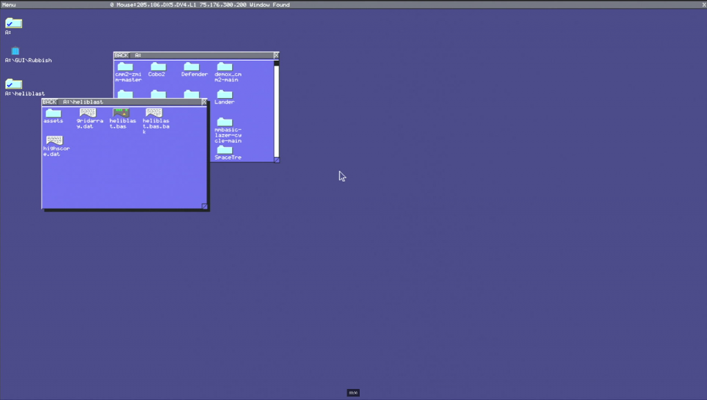

I know - The CMM2 already has a fully working file manager. But this started as a bit of fun. It was originally going to be a GUI for a graphical text adventure like the old Magnetic Scrolls "The Pawn" or "Guild of Thieves".
Then it sort of morphed into a front end for launching programs or managing files.
It's a work in progress, so it almost certainly has a few bugs, and there's a lot more features I want to add to it (Ram Disk, Networking etc.), but I want to spend time on some games dev, so it's going back on the shelf for the time being.
It happily handles files and directories being moved, renamed. Launching programs. Copying links for folders to the desktop (for easier launching) and it has a Rubbish bin for deleted files, so that they can be recovered.
It does require a CMM2 Gen 2 as it uses the mouse. It is by no means intended to be an operating system - I 100% still prefer that the CMM2 boots straight to BASIC and not to an OS. But part of my thinking was that if you did want to make a system that was easier for the grandkids to launch games etc. then this would suffice. It would be simple to disable the disruptive commands (Delete, Move, rename etc.) so that it was only a file launcher.
Video of it in action here:
https://1drv.ms/v/s!AnkZn9N9Pt1fyMISsNqOildOm0r6jA?e=cCDuMg
Download source here:
https://1drv.ms/u/s!AnkZn9N9Pt1fyMIRhgu0qZTfhJjlIQ?e=dw0vZn
