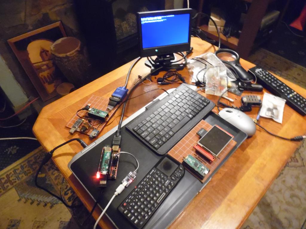

I've fallen for pico2 stuff. dropped into usb vga and olimex for hdmi and just picomite ili9341. what does 2350 d0 for ili glcd? is it worth it?
vga has mode 3, cool.
hdmi same mode 1 to 3 then other low res modes with more colours, I think.
is pico2 the future?
