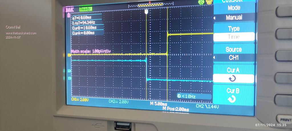

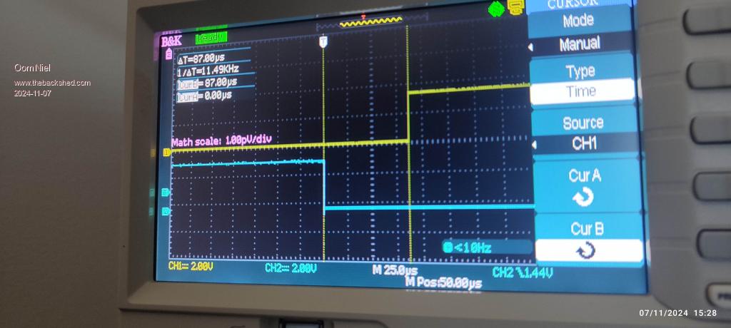

I get latency of between 57 to 87 micro-Seconds as shown in this image:
The blue trace is a simple button press and the yellow trace is the interrupt service routine toggling a pin high.
When a more substantial program is running, like pulling data from an MQTT broker the latency increases to about 10 mS and it can vary greatly (as much as 300 mS).
