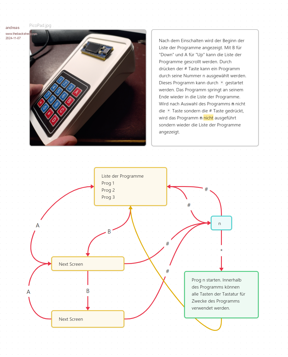

I plan to write a kind of program-selector for my "picopad". The programs will be independent - so they don't need any common variables. Every program will have a final line calling the top-level menu to select the next program to start. the top-level program will just start the program selected. So it will be a large menu and many independent programs without common variables.
Sorry for the German text - it was generated with obsidian for myself only but could possibly show what I intend to do? It is a kind of state diagram.

When you run a MMBasic program it can have a file$ and a commandline$. So in theory you can have:
In the menu program:
RUN "Myprograms","200"
When Myprograms.BAS runs it can use
GOTO MM.CMDLINE$
200:
'do a program here
GOTO LEAVEIT
LEAVIT:
RUN "MENU"
I've not tried this, but it looks like it should work. :)  You can put a lot of small programs into one big one in this way. FLASH RUN doesn't take a command line argument so it becomes more complex to do this sort of thing. I've usually had to resort to VAR SAVE.

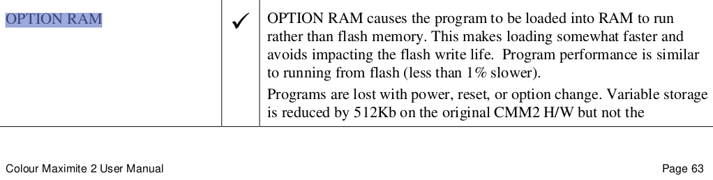

I start missing the OPTION RAM of the CMM2 in PicoMite! Would be nice to have an OPTION not to copy something from flash to flash (RUN filename) but from flash to ram for execution.

Hey! How about an OPTION RAM (the CMM2 style;)
-andreas

There isn't enough RAM in a PicoMite to have an OPTION RAM command. It appears that I was naïve in thinking that it had enough to run programs from there!
The CMM2 is a different beast entirely! Quite a lot of RAM and extendable.

You could use the menu selections to point to a "jump table". Each entry in the table points to the "address" of the program (i.e. a label). At each label location there is either the program or a FLASH CHAIN to point to it.
That makes the menu items nice and easy to maintain. You can change their destinations in the jump table without moving programs around, you can replace one program with another - even if it's in the other flash slot - permanently or temporarily without disturbing anything. You can work with numbers from the menu selection and the "jump table" converts them to label strings. It could be DATA statements.
