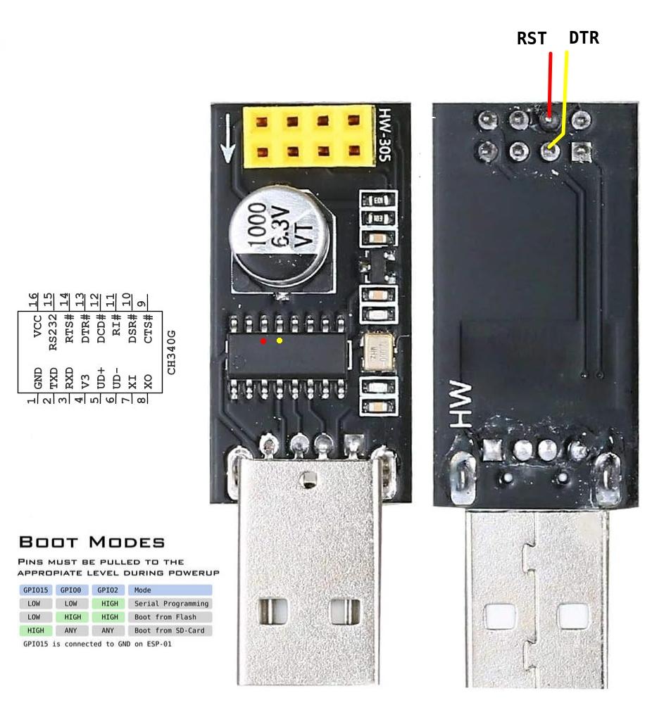

I'm playing with the ESP-01 using ESPNOW. Dug out my modded ESP-01 programmer
 and thought I should share how I modded it. It works with Adruino IDE.
 I did this a while back and can't recall the web site I got most the information.
 When looking I did one with a button. It works but when I read about this
 mod I had to try it out. A few other used transistors and they too worked.
 This is plug and play the Arduino IDE using Esptool it just works.

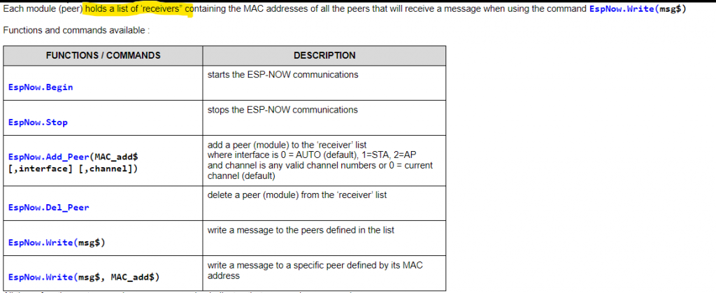

This the ANNEX32 help page

  Volhout said  ESP-NOW experience  ... I have no idea if it can do broadcast mode or UDP.
Annex can broadcast ESP-Now--it makes it easy to broadcast with a message ID, and only the receiver having that ID responds or takes the requested action. I would assume that an ESP device using ESP-Now with C could do the same. The mac address for broadcast is  "FF:FF:FF:FF:FF:FF".
Since Annex can do UDP, I'd assume that ESP-Now with C could also.
