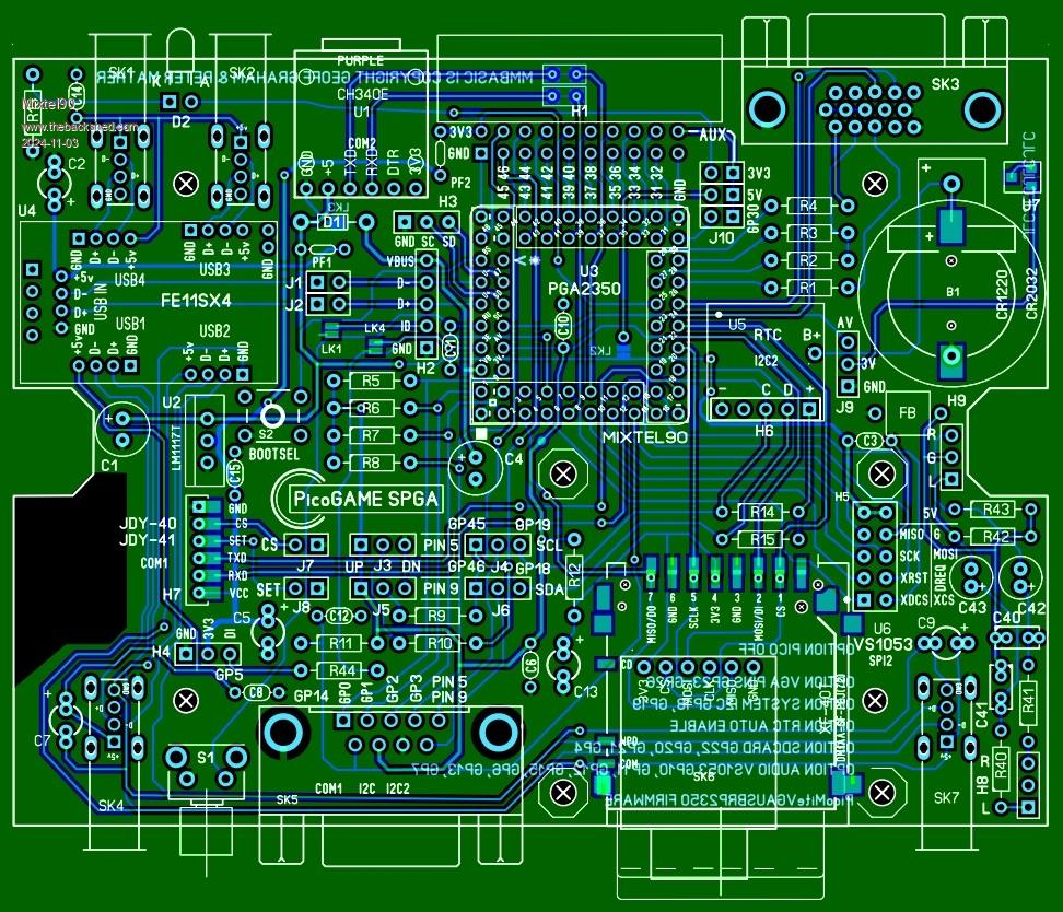

This might be the final PicoGAME as we know it. Probably the last one to have the DE9 connector on it anyway as everything is moving towards USB.
This one uses the PGA2350 too, which might be handy if you already have one and it's in danger of being shoved into a drawer!
Video is standard 16-colour VGA
Audio uses the VS1053 codec module with headphone output. Line output can be added if required.
It's pretty good on connectivity:
One Atari joystick (with a couple of extra buttons)
Two analogue inputs, or an analogue joystick (not tested)
NES / SNES controller (two with an adapter & software changes)
One or two I2C controllers (you'll need adapters of some sort)
One COM port or transparent RF COM port
Seventeen GPIO pins, seven of which can be ADC
Four USB-A ports from an internal hub
It fits the same enclosure as matherp's new "reference design".
The front and rear panels are on a single board and will need cutting. This is to save money.
Unfortunately both boards are more than 100mm long so won't be at JLCPCB's special offer price.

Hi Mick,
The H4 jumper is a bit awkward. Looks like you can short 3V3 and GND with it. Maybe swap pins 2 and 3 will make it monkey proof.
I am impressed how many options there are with this board. You really put everything in it. And kept compatibility with the PicoGameVGA 1 design for portA.
Nice job Mick. Are you building one ?

Posted: 08:05am 03 Nov 2024
You could, but the pins are in the same order as those on the WS LEDs that I have - it's a front panel LED connector. H4 is not specified to have a jumper supplied with it (in fact there shouldn't be jumpers on any Hx, only on Jx).

Surprise...
U7 is SMT. I would have thought you avoid SMT.... TO92 unobtainable ?

Posted: 08:22am 03 Nov 2024
I couldn't find a TO92. :( I don't know if they are still available from somewhere. I didn't want to use SMT. However, J9 will let you play as anything can be put between the AV and GND pins.  :)
