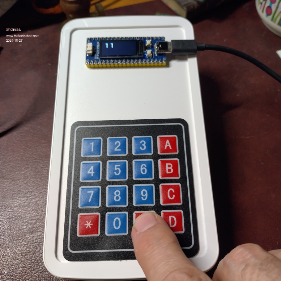

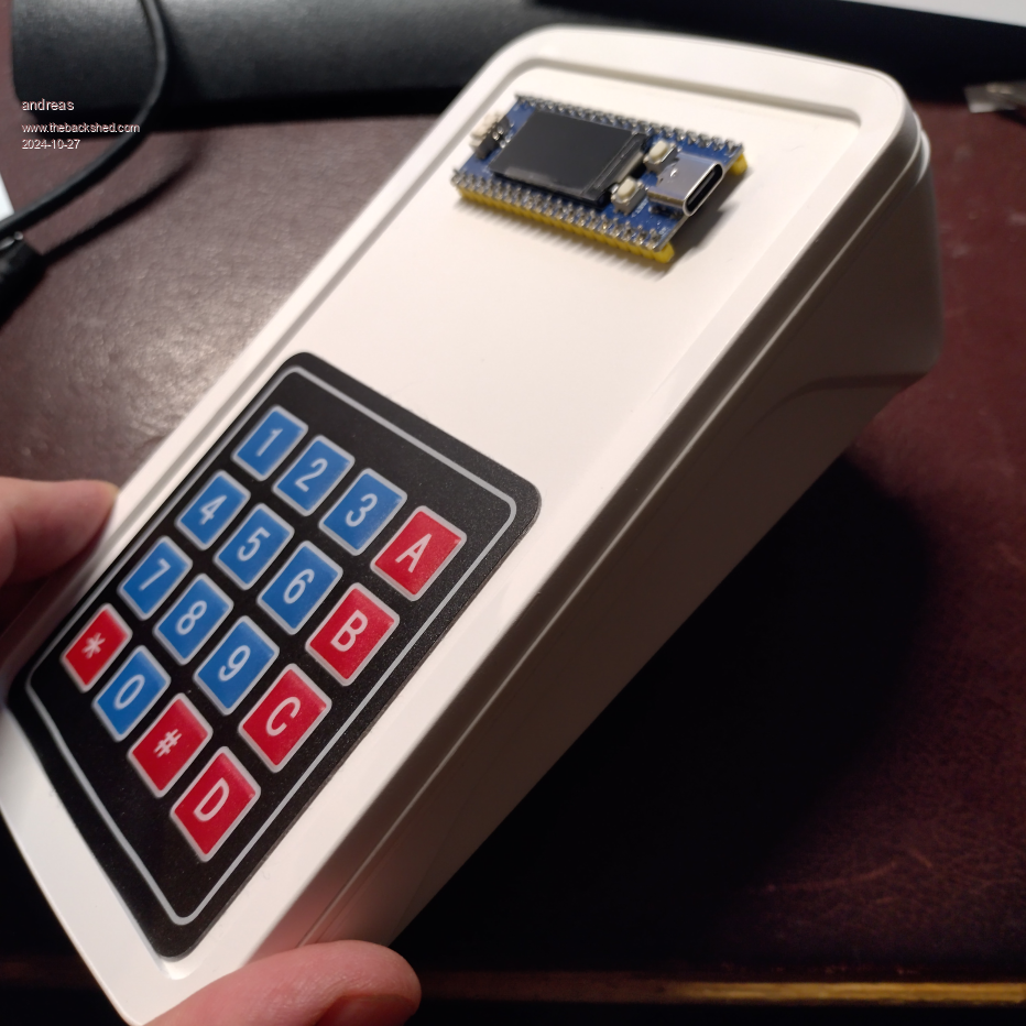

Build a "programmable calculator" ;-)

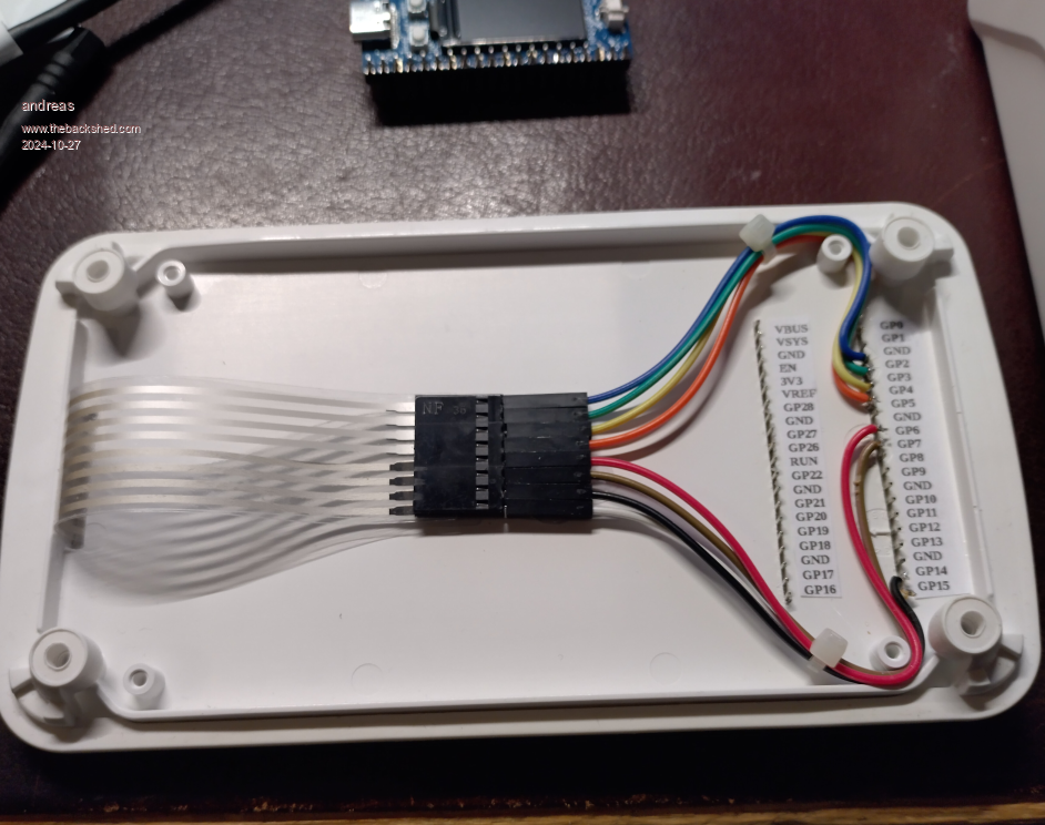

Everything it does: connecting a RP2040-LCD with a keypad. Programming is up to you!
Just an inspiration

Device KEYPAD Taste,myint,GP15,GP14,GP7,GP6,GP5,GP4,GP3,GP2

Good ideas! The box is large enough to build in all these ideas.
My primary reason to setup this calculator is the game "Hare and Hedgehog – Game of the Year 1979". There you have to calculate the number of carrots to move from a starting field to a destination field. Even better would be a calculator which tells you how far you can reach within 2 or 3 or 4 rounds or what will be the "best move" to reach the final destination as quickly as possible. So I will use it as a "carrot-calculator" & "gaming-advisor"
