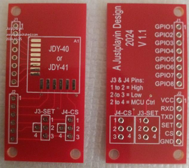

If anyone is interested, here is a breakout board I created for the JDY-40/41 modules.  Be kind... It is the first PCB I ever designed. 😲
JDY-40 41 Breakout - V1.1.zip
--Curtis
Posts: 9229
Posted: 05:21pm 24 Oct 2024
That's a nice one. :)  I did one to put on a breadboard quite some time ago.
The gerbers are in the usual place. :)

Justplayin
Joined: 31/01/2014
Posts: 330
Posted: 05:33pm 24 Oct 2024
@Mixtel90
I liked your design and had an order of boards made. However, the pin header holes were the size of vias making them useless.  Don't know if it was a manufacturing error or a design error. That was what inspired me try and design my own board.
--Curtis
Posts: 9229
Posted: 05:48pm 24 Oct 2024
Ah...The holes were 0.72mm dia. Too small for male headers, as you noticed. :) At that time I used 0.6mm diameter wire (the silver plated copper crafting sort) instead of pin headers as it's kinder to the breadboard. I still do that a fair bit. Unfortunately I keep picking up one particular breadboard that need a hammer to plug anything into it and that bends my skinny wires. :(
I've now added a version to take conventional pins if anyone wants one.
Edited 2024-10-25 03:50 by Mixtel90
Justplayin
Joined: 31/01/2014
Posts: 330
Posted: 06:15pm 24 Oct 2024
Good to know I can stop cursing the PCB manufacturer. 🤪  The positive side is I finally got inspired to learn to use AutoTRAX DEX to create my own PCBs.
