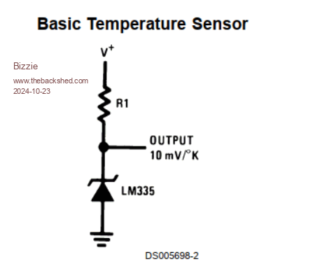

I started to build a board with a 28 pin MicroMite with a 12k resisor as the datasheet indicated. During testing of the board I relised the MM would see 12v! if no sensor was connected or the sensor went open circuit. See below example circuit.
Has anyone used these safely? I can not use the HTU21D's as the sensor is on the end of 12m leads and works perfectly doing manual measurements.

You have a few options:
1.
a simple potential divider from the output to ground, Say 10:1 ratio and then scale up the readings in software,
2.
Feed the input into an op-amp set up as a buffer, with its supply at 3.2V Then if the input every goes higher then the output will just sit at the supply rail.
3.
Looking at the cct, it's a zener, so maybe a 3V zener at the MCU end to conduct if the voltage ever goes above 3v. I'm not sure how much that would affect the readings, depending on how high they get.

However as you already have the LM335s a 2:1 voltage divider across the LM335 (2 x 33kΩ perhaps) with a Schottky diode from AIN to +3.3V for open circuit protection.
Option 2. Replace R1 with a 1mA current source fed from 5V to 6.6V and once again a 2:1 divider.

The LM335 does *not* require 12V or a 12K resistor. The resistor value is chosen to put between 400µA and 5mA through the LM335 at the voltage and temperature you are using. The maximum voltage is 3.3V for the Micromite (limited by the ADC input).
At 3.3V the maximum temperature you can read is a bit less than 57°C.
The maximum value for the resistor at this voltage has to be less than 384Ω.

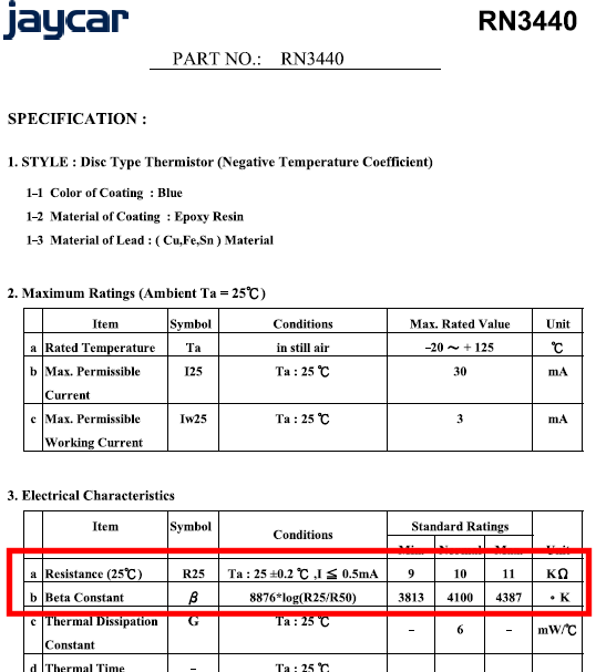

so looking at the datasheet for the JayCar part RN3440,
it looks ideal (R25=10K, Beta=4100). Grab a load and make up a loom with tons of these - 12m of wire won't significantly affect the resistance of the thermistor at these currents.
