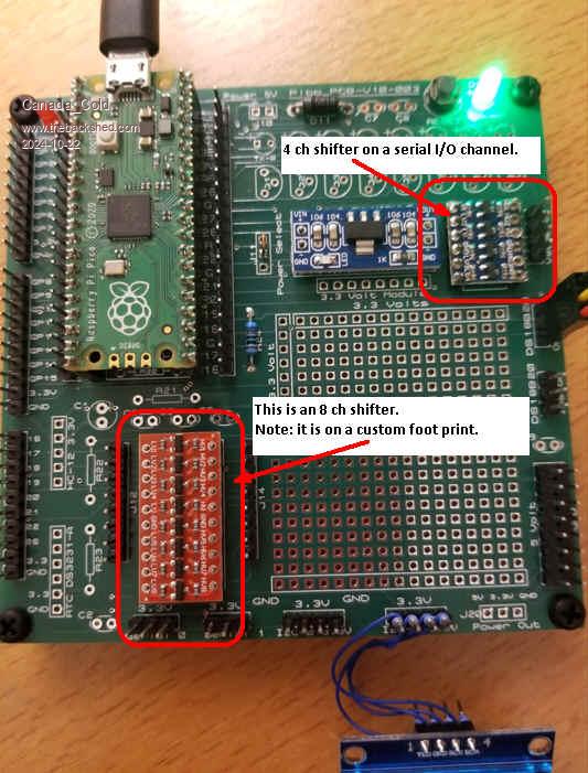

Canada_Cold
Joined: 11/01/2020
Posts: 57
Posted: 11:32am 22 Oct 2024
Hi Plasmamac,
I use the 4 ch level shifter and the 8 ch in my designs.
Note: The 8 ch is not a standard footprint.   The distance between the input and output is 435th.   Therefore a custom footprint is necessary.  But if you need lots of I/O, this does save some board space over using 2 of the 4 ch units.  The 8 ch units are available on eBay.
Don
