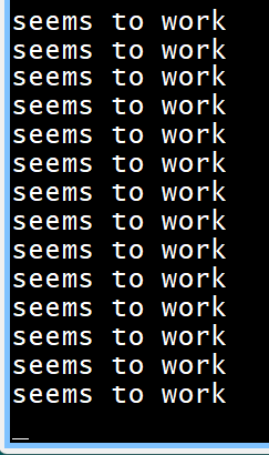

First time
Phone to ESP32 to PicoMite
I am such an awesome c-programmer
