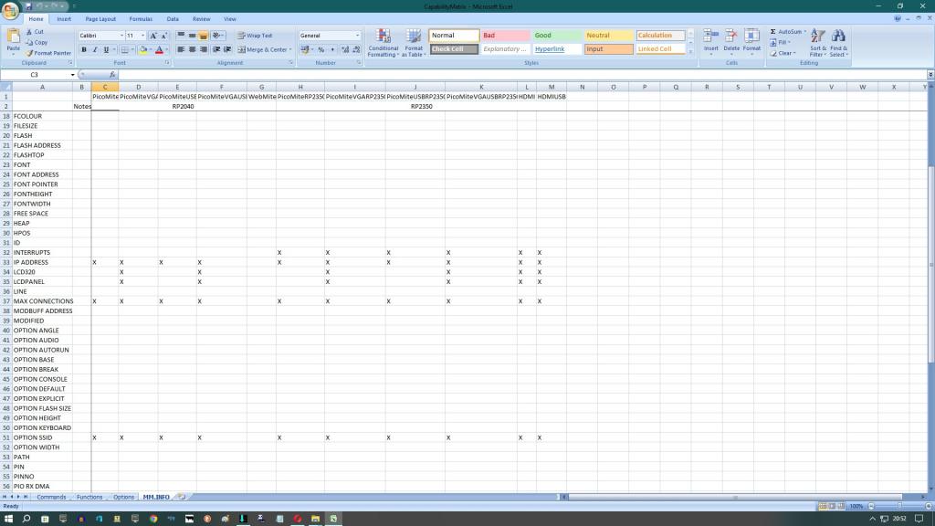

CapabilityMatrix.zip
Attached is an excel file showing for each version of the PicoMite firmware every command, function, option, and mm.info capability which is relevant (as at V6.00.00RC8). This will be used by Geoff and myself as the basis for getting to grips with writing the manual(s) for V6.00.00 but may be useful for users in the meantime.

what's it mean for joe user?

Thanks for that Peter.
Now I just have to find the time to update MMEdit syntax files to match.

Thanks Peter, looks like a handy table...
I just noticed there's an "mm.info(systick)"
What's that indicating? (I hadn't seen it before, and nothing in the manual)
Posts: 12042
Posted: 10:01pm 12 Oct 2024
  Quote  I just noticed there's an "mm.info(systick)"
It's a 24-bit counter that counts at CPUSPEED. Really there for my testing but can be used for very short interval timing as long as you deal with the 24-bit roll-over

  matherp said  Attached is an excel file showing for each version of the PicoMite firmware every command, function, option, and mm.info capability which is relevant
Your table does not indicate with a plus sign the change in the flags (2nd bit) of the Sort command
