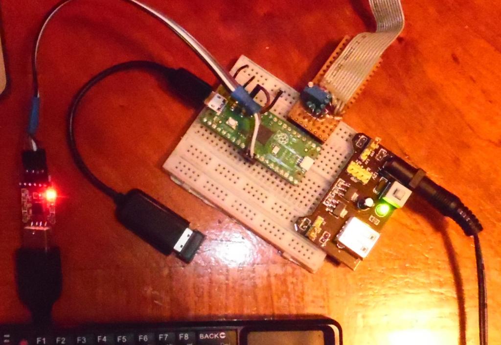

I've used these and similar   https://www.aliexpress.com/item/32382955228.html
