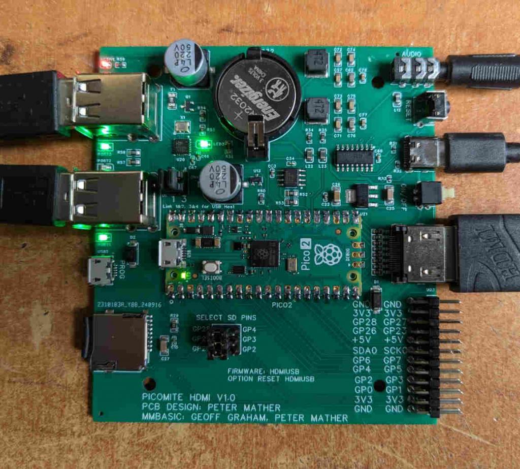

I'm very pleased with this one - everything works perfectly first time.
There are a couple of tiny changes in the gerbers from my prototype. The top left mounting hole was in the wrong place so that is corrected. Also I've changed the electrolytics to tantalums. The box is the MULTICOMP MCRM2015S.
Notes on use.
Solder the PICO2 direct to the motherboard ensuring it is completely tight to the PCB
On the rear side of the board there are 4 holes without solder mask. Apply liquid flux to these and solder through them. These connect the USB programming micro-USB, Pin GP23, and improve cooling for the USB HUB chip.
Leave all jumpers off the board and insert a micro-USB into the PROG connector
Load up the HDMIUSB firmware (V6.00.00b10 or greater) then remove the microUSB connector
Install jumpers to enable the USB hub circuit (1 to 2 and 3 to 4)
Install jumpers to enable the SDcard (default is GP26, GP27, and GP28)
Install a CR2032 battery
Connect a USB-C cable and an HDMI cable and press the on/off switch
You should then get the Copyright logo on the screen
Type "OPTION RESET HDMIUSB" to fully configure the board and you are good to go.
To update the firmware turn off the power switch, remove jumpers 1 to 2 and 3 to 4
Hold the boot switch down on the Pico2 and insert a microUSB cable in the "PROG" socket. Remove the microUSB, replace the jumpers and power back on.
The onboard USB hub allows you to connect up to 4 USB devices, keyboards mice, gamepads. A green LED adjacent to the USB connector will light up to indicate they are operational.
Enjoy
As always the design files are free to use and cost for 5 motherboards from JLC fully populated is $93.77 add a PICO2 and you have a Boot to Basic computer with HDMI output, Battery backed RTC, Audio output, SDcard and 4 port USB Hub for less than USD30 - can't be bad
I don't build and sell any of my designs so organise groups or ask Grogster nicely if you want one.
To reduce the price from JLC slightly remove the headers and other through hole parts from the BOM/P+P and solder them yourselves

That's a nice board, Peter. A surfeit of greenness. :)  I see a rogue red LED sneaked in when you weren't looking though. ;)
