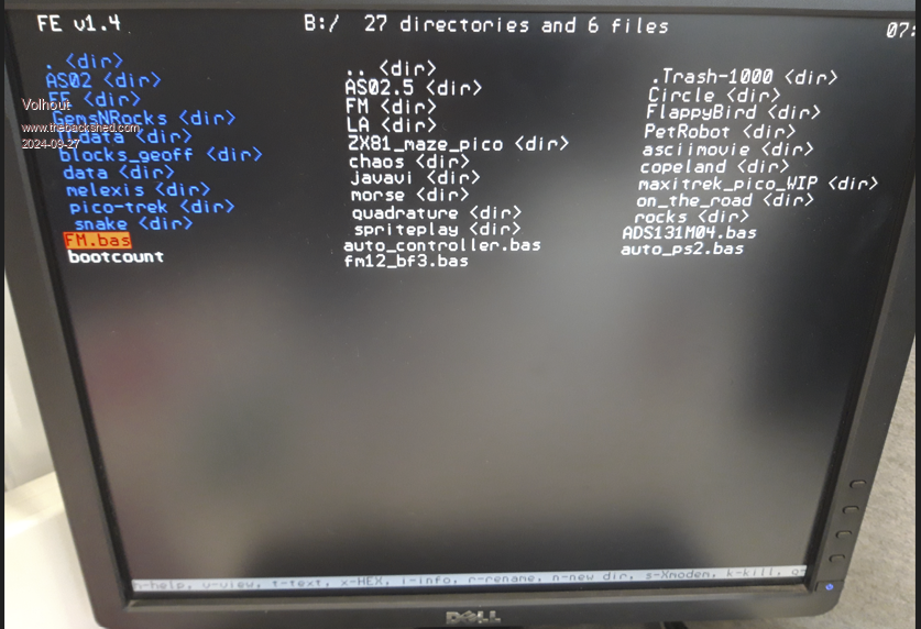

Hi Jim,
Thank you for File Explorer for pico. Some minor remarks:
- In VGA Mode 1, the file highlighting (colouring) is only in the first column.
- The help text banner is wider (800 ?), and does not scroll, so some parts are not visual on 640.

@Volhout
I haven't any experience with the magic that produces the colour in VGA mode 1 but I am guessing that I need to start the text on a byte boundary. The program simply divides the pixels by 3. I will do some adjusting.
The help banner is as short as I could make it. The main one is 'h' which shows the full help.
You could try a smaller font. 'f' toggles between font 1 and 7
We were spoilt with the size of the screens on the CMM2.

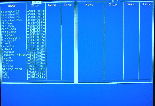

I also started programming a file manager once. (only the basic structure and optics)
'MartinCommander ;-) MC

maybe we can try to combine the best of all of them
Martin
