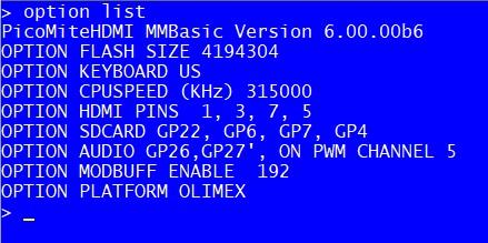

Currently I am trying to configure a standard RPi Pico 2 which has the HDMI b6 firmware installed (non USB). I used OPTION RESET OLIMEX and the following options have been automatically set:
At this point, things appear to be as expected; and indeed I am able to read a uSD card inserted into the Olimex SD socket.

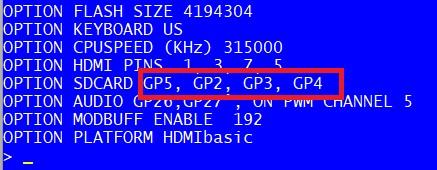

Note the 372000 value in the above error message which I had just previously tried. So, now I'm thinking it is because PLATFORM is set to OLIMEX and perhaps it should be set to HDMIBasic instead. I typed OPTION RESET HDMIBASIC holding out hope it would let me set the cpuspeed value needed for 720P but I noticed the SD pins changed (shown in next image below) so decided to go back to OPTION RESET OLIMEX (hence SD pins now correct once again). [Peter: Note Platform shows 'HDMIbasic' with a lowercase 'b' - trivial, just letting you know]
Then having typed OPTION RESET OLIMEX, I thought how about just changing the PLATFORM option to HDMIBasic (leaving the SD pins as they should be). All looked good, so went ahead and changed CPUSPEED once again to 372000 and up popped the same error messages as above concerning invalid speed value (having tried 378000 too).
