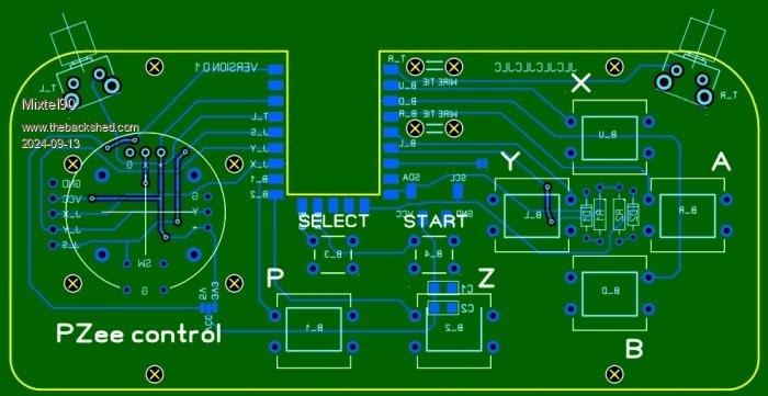

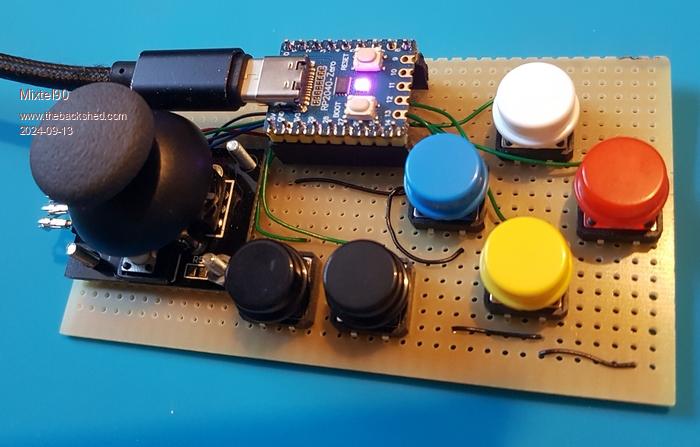

My PZController test rig.
and my idea for a PCB. It got longer, as I mentioned. The RP2040-Zero is soldered to the back of the board. Only rear protection is needed with this arrangement, which makes life a lot easier.
Yes, Tom, I don't mind changing to USB for a controller standard at all. It's just a case of making sure that USB is always implemented on systems that will be used to play games.

  Mixtel90 said  My PZController test rig.
It's very nice Mick and I'd be very proud to have concocted it myself, but with regards standards it is IMO a dead-end.
  Quote  Yes, Tom, I don't mind changing to USB for a controller standard at all. It's just a case of making sure that USB is always implemented on systems that will be used to play games.
I think @Volhout is suggesting that "we" set a standard and say "this is it for games playing, like it or lump it".

Posted: 10:58am 13 Sep 2024
IMHO Volhout is right. The difficult bit is to find the standard to use. There are so many of them to choose from. :)
This is *exactly* why PZee-control was thought up. There are no standards, every games console has its own and even when they are similar they have different connectors. The only thing approaching a standard is the Atari "5-switch" joystick with it's original, standard wiring. My thoughts were that with our own standard we aren't at the mercy of the games market controller availability. We have the power to define *everything* about it, hardware, firmware & games.
Basically everything except a keyboard or the aforementioned joystick is a dead end at the moment - there are no alternatives. If we want anything more we have to either create it or find a commercial device and hope that it will still be available in the future.
