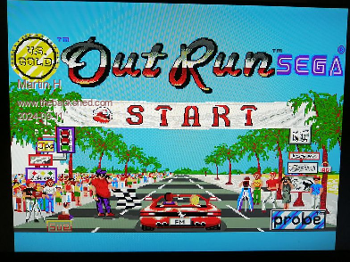

Showing 16 Color BMPs using MAP Command:
'The Power of 16 Colors
'PicoMiteHDMI only - MMBasic Version 6.00.00b8 or higher
'Reads and shows 4 Bit uncompressed BMP Files in up to 640x480 resolution
' and sets the Colors using the new MAP Command
MODE 2
Map reset:Map set
CLS
Dim integer w,h,f,cl,c
 MODE 2
 Read File$:If file$="end" Then Restore :Read file$
 Open file$ For random As #1
 read_BMP_Header
 Map set
 If h>240 Then MODE 3
 hi=MM.VRes
 yofs=(hi-h)/2
 yofs=hi-yofs
 Seek #1,of+1'54+65
 For y=yofs To yofs-h-2 Step -1
   For x=0 To w-1 Step 2
     l$=Input$(1,1):cl=Asc(l$)
     Pixel x,y,Map(cl>>4):Pixel x+1,y,Map(cl And 15)
   Next
 Next
 Close #1
 'display the used colors
 For c=0 To 15:cl=Map(c):Box c*20,0,20,10,,cl,cl:Next
 Pause 2000
Data "chess.bmp","wasserfall2-4.bmp","waterfall.bmp","ST_Graph.bmp","outrun_a.b
mp"
Data "end"

the Program and some Sample BMPs
DecodeBmp.zip

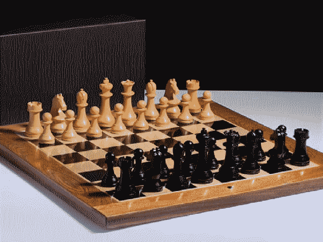

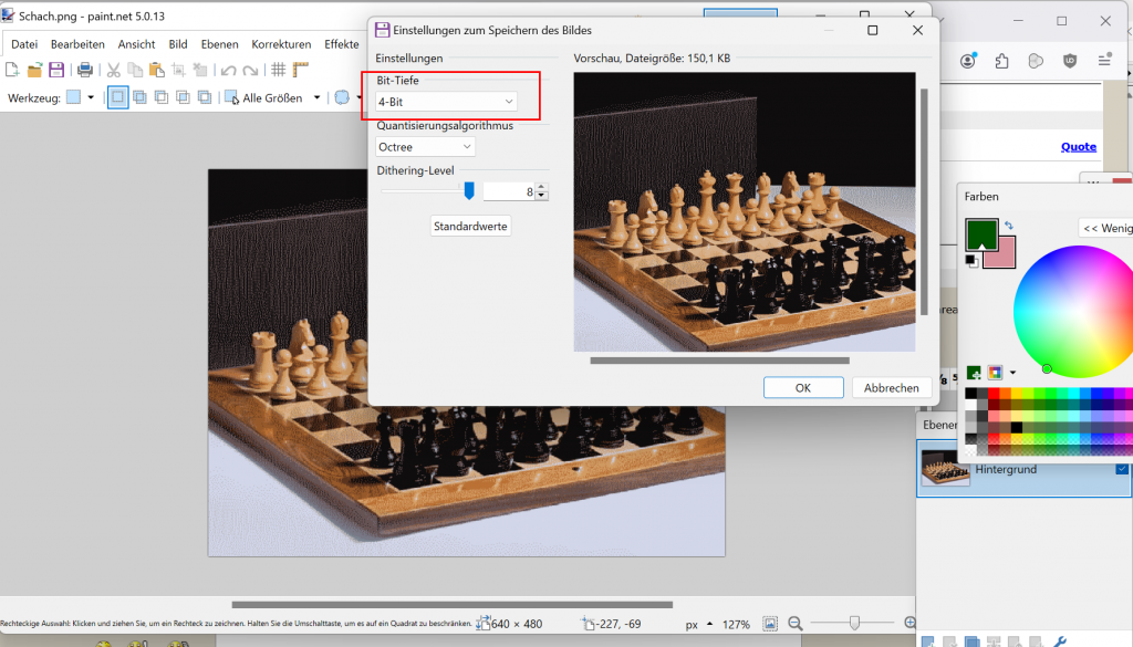

Posted: 01:57pm 23 Sep 2024
They are dithered by my Paint Programm, find a nice Picture,
resized to 320x200/240 or 640x480 and saved as 4 Bit BMP.
so you can put together your own little slideshow.
But, the big advantage is that you can work in Mode 2 as before, but you are no longer bound to the RGB(121) colors
