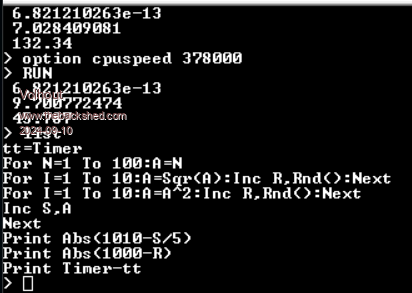

Pico2
6.821210263e-13
17.5892694
Time (MM:SS.ms) 00:00.56.271
> option list
PicoMiteHDMI MMBasic Version 6.00.00b6
OPTION FLASH SIZE 4194304
OPTION COLOURCODE ON
OPTION KEYBOARD US
OPTION CPUSPEED (KHz) 315000
OPTION DISPLAY 20, 40
OPTION SDCARD GP5, GP2, GP3, GP4
OPTION AUDIO GP6,GP7', ON PWM CHANNEL 3
OPTION MODBUFF ENABLE  192
Pico
  Quote   6.821210263e-13
9.700772474
Time (MM:SS.ms) 00:00.60.436
> option list
PicoMiteVGA MMBasic Version 5.09.00RC5
OPTION KEYBOARD GR, 0, 0, 0, 0
OPTION CPUSPEED (KHz) 378000
OPTION SDCARD GP10, GP12, GP11, GP13
OPTION MODBUFF ENABLE  180
tt=Timer
20 For N=1 To 100
25 A=N
30 For I=1 To 10
40 A=Sqr(A)
45 R=R+Rnd(1)
50 Next I
60 For I=1 To 10
70 A=A^2
75 R=R+Rnd(1)
80 Next I
90 S=S+A
95 Next N
100 Print Abs(1010-S/5)
110 Print Abs(1000-R)
Print Timer-tt
Edited 2024-09-10 03:12 by Martin H.
'no comment

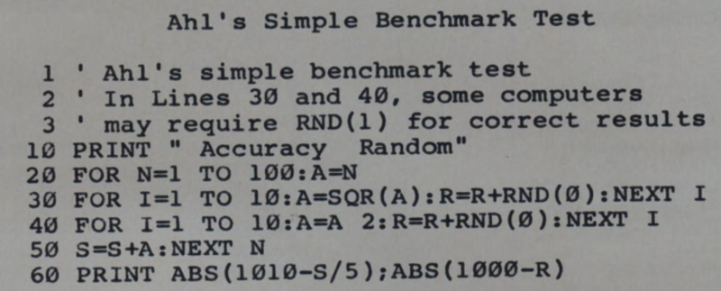

The Colour Maximite 2 got 21 milliseconds - 62 times the speed of the Agon Lite (and almost 6,000 times as fast as the Commodore 64 BASIC!).
I should note that I used the original David Ahl listing (below), which condenses the logic onto fewer lines. We know that makes a slight improvement in speed (as opposed to it all being separate lines).

For the sake of curiosity, I split the logic into separate lines, and it did add 4 milliseconds to the time. Not much compared to other computers, but a significant portion of it's own time (20% longer). It does show how the slightest change can affect each benchmark to favour/detriment from one machine to another.

RP2040 (Geek) board at 378MHz is 45ms (132ms at 133MHz).

Might save a couple of clocks with:
Timer=0
Print Timer
Posts: 6192
Posted: 09:12am 10 Sep 2024
Tried that, takes longer.
