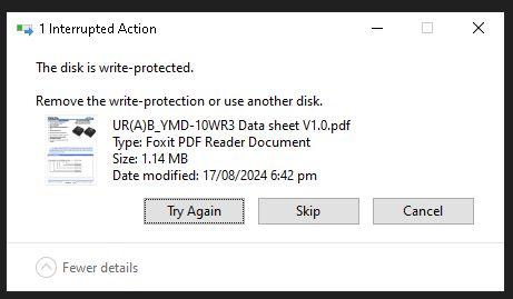

This started happening today, to my BACKUP USB flash drive.
The drive is a SanDisk 64GB USB3 compact/low profile.
It's always plugged in, and I use it for backup purposes, but NOT MY ONLY BACKUP.
It is the local backup, but I also have a backup server, and cloud-storage backup, so I don't really care if this drive dies - I have multiple redundant backups.
However, this is interesting, cos as far as I know, with most standard USB flash drives, you CANNOT write-protect them - you can always write to them, provided there is space.  This drive has 11GB free.
But if I try to copy ANY file to it, Windoze throws an error:
Have unplugged it, tried it in other ports, even tried it on Linux, but Linux can't write to it either - reports the same problem, that it is write-protected when it isn't.
Now, I know that ALL flash media has a limited life, so I am just wondering if the drive itself has simply put itself into read-only mode, as it has detected that the flash cells are worn out, or the controller was otherwise detecting that writing was starting to be a problem for it.
That's the theory I am going on right now - does that sound plausible?

@ Grogster, Have you tried Looking at the Properties of that flash drive in Windows? the Read Only Flag may be checked. and or check drive permissions in Linux

Thanks for all the pointers.  I can confirm, that this is a genuine SanDisk product, as I bought it here in NZ from one of the computer shops.  It has been very good up until now, and I suspect it has simply locked itself to protect the contents.
Flash-drives are cheap an plentiful, so it won't be an issue for me to replace it.

As far as I know, there are two reasons for a Write Protect (read only).
1. Wear leveling protects the data carrier as the error rate increases significantly. This can happen when the card has reached the maximum write/erase cycles. This process is normally irreversible. If there is a manufacturer tool with which you can read out the flash status (like SMART) you could check this.
2. the Write Protect flag was set due to an error condition. This can be reset under Windows with “diskpart”:
- Hit Windows Key + X on your keyboard, and select Command Prompt (Admin) from the menu.
- Type diskpart and press Enter.
- Type list disk and press Enter.
- Type select disk #(ex: Disk 1) to select the disk which is write-protected and press Enter.
- Type attributes disk clear readonly to change the disk’s properties so that it is no longer read-only and press Enter.
- Type exit and press Enter twice to exit Diskpart and Command Prompt continuously. Re-plug your USB flash drive to check if the write protection error is solved.
