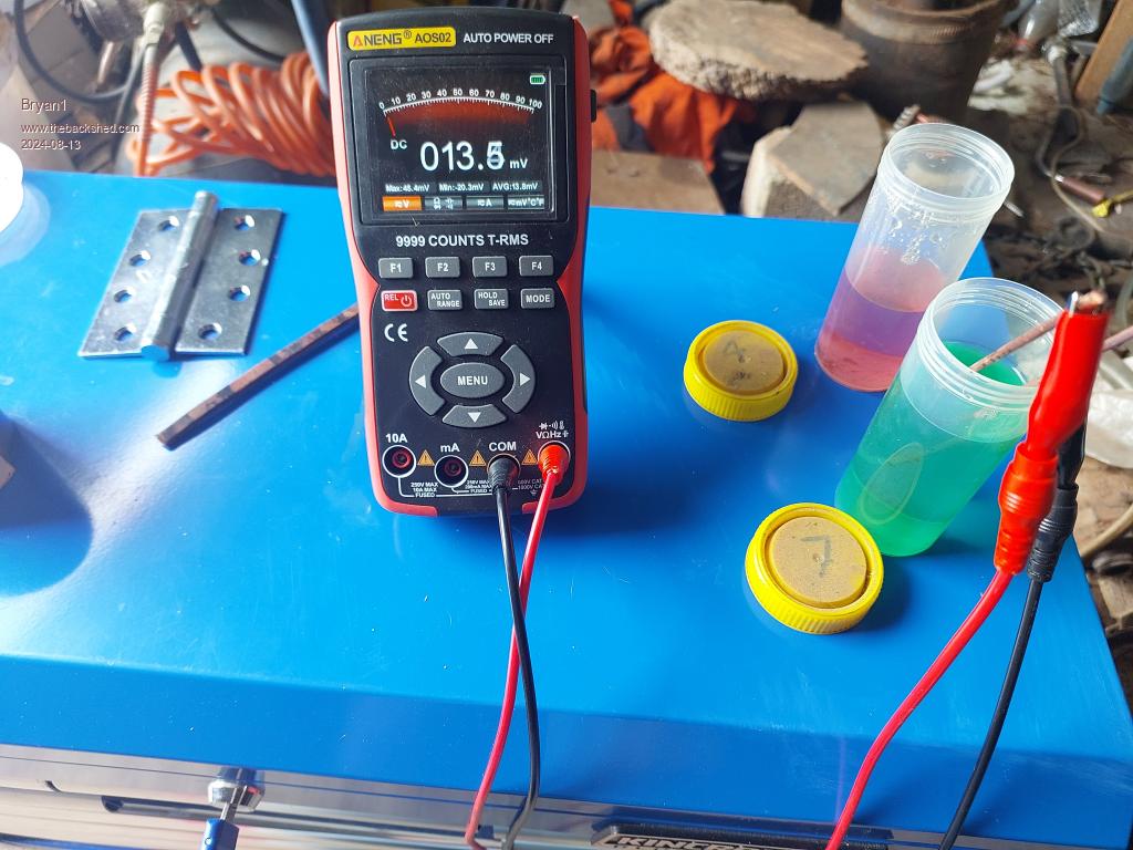

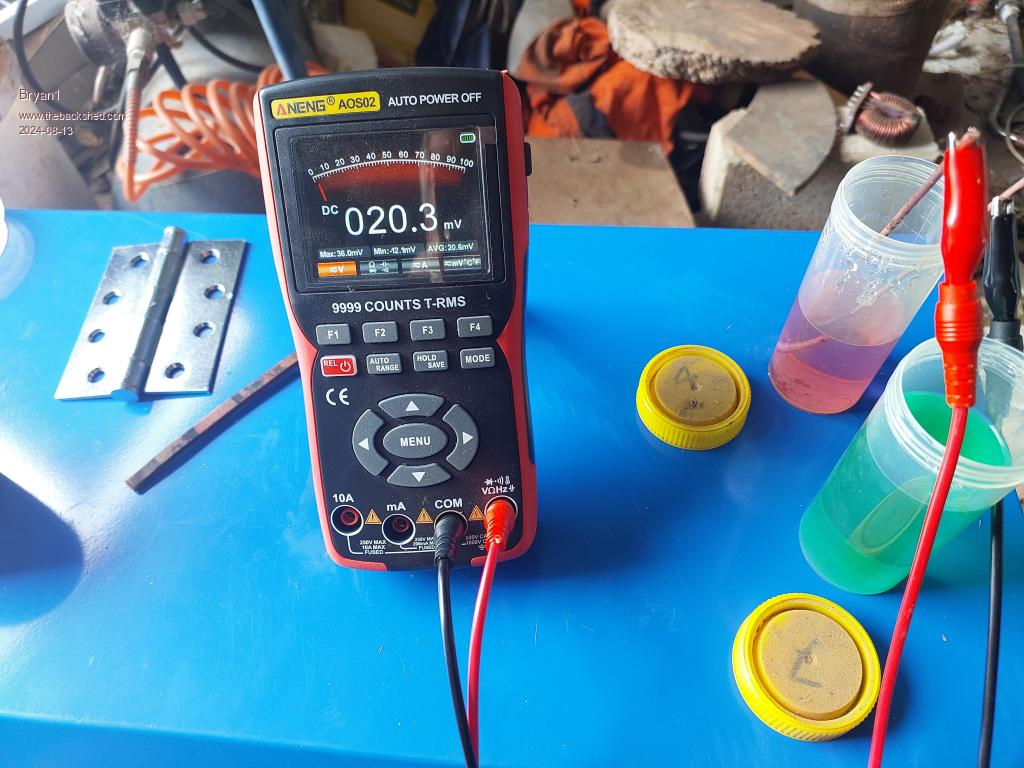

So on reading some of the probes are coated in silver chloride where one probe is in a known PH solution while the other probe is exposed to the liquid. Now just had a look and guess what I found in my gear, some silver chloride powder in my Dad's gear called Horosilv So may just have to coat some copper wire and see if I do get a differential reading between the probes and found I did need to have both probes in the same solution. Ok coated some 2.8mm wire and put the probes in some PH4 buffer ![]() Then some PH7 buffer ![]() Now it did take a minute or so for the voltage to stabilize so the first rough trial is getting there. Cheers Bryan |

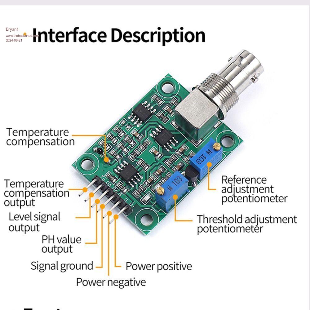

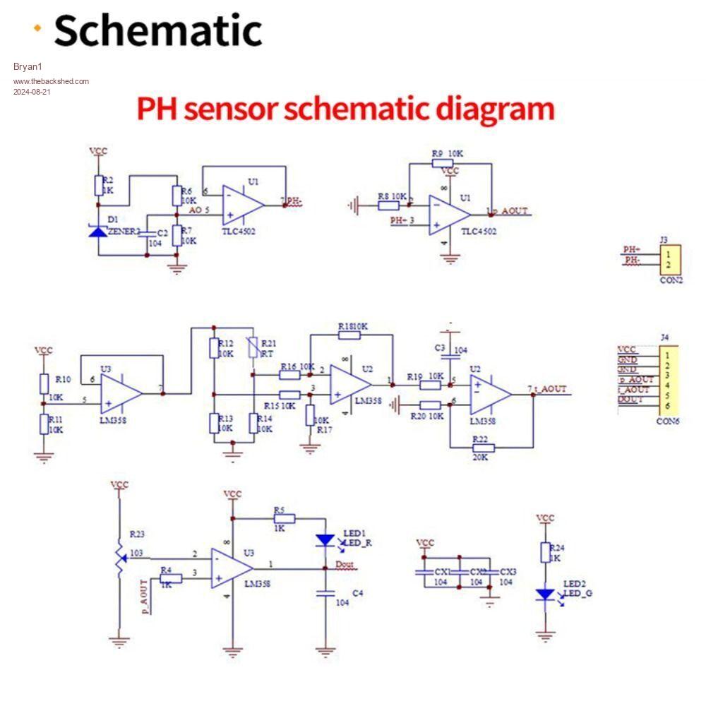

G'Day Guy's, Well finally got some info on this PH sensor and here is the schematic for the sensor board. ![]() Now here another pic showing the connection setup. ![]() Just checked the tracking and it's still a week away but now got some info to work with. Regards Bryan |
