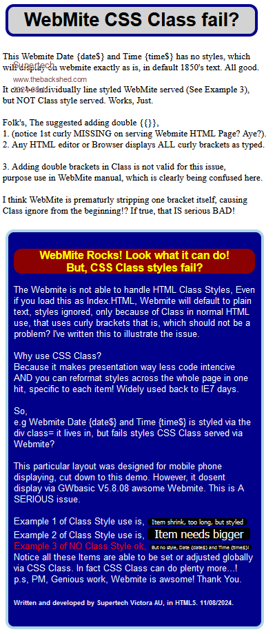

Unfortunately my post is part misleading, but topic is serious accurate as I was blaming HTML standards while not properly understanding how WebMite server's the HTML its meant to be compatible with.
Sadly, I think only PM will understand once read and studies issue more carefully.
Just a bit of me,
Yes I am new looking but been following this forum quite a while. I actually support a lot world wide.
e.g Done plenty PicAxe since arrived in AU with truckloads of other things in industries...to many to list.
I am sadly limited by health , a skinny (now old) man with faulty liver gene's from birth, but try not to let it hold me back.
Issue at hand,
The best way for PM or anyone else to see the issue,
1. I decided to write a demo HTML which shows for itself what is going on. Self explanatory. Just write in the code!
2. PM, use this demo to fix issue please as it is seemingly 'a translation issue' only you can understand at hardware firmware level. Also this problem will affect ALL WebMite uses, even Geoff demos and manual, specifically HTML compatibility going forward. I'm an ex programmer of many years, so I know, but not as Genius as what you've pulled off here.  Quote of David Letterman, "There is no 'Off' position on the Genius switch." Absolutely!
3. I put considerable time to write it for me to help you sort it and teach other members semi Proper HTML5 as I see a lot of horrendous HTML in this forum, no offense meant dear member's!
For those who are proper HTML proficient, It speaks for itself, please load and read notes embedded in it.
Anyone can  and try the demo here index DBA 110824 for Webmite TBS.zip by
A. Loading into any Browser as is,
and comparing it with,
first, rename this HTML to default index.HTML, then
B. Loading into WebMite itself and browsing its served page, even via a mobile phone it is designed to display on, comparing results. For those that do this, you'll see my shock...
I put an exact snapshot, to show how it 'should look' on any proper browser, and have written it in latest HTML5.

Webmite uses  curly brackets as the syntax element to specify value substitution. If you want a { to be transmitted to the browser you must replace duplicate the {
So in the in the example above
     <style>
  .myhitxt {
  font-family: Tahoma;
  text-align: center;
  color: darkgrey;
  background-color: black;
  border-radius: 10pt;
</style>
the line should be
  .myhitxt {{
Note also CSS files etc. do not need to be embedded. Just make sure the basic program has code to respond to the browsers request for the css file

One possible problem I see in your HTML is it is not ASCII. I haven't tried your code yet but I worry about characters greater than chr$(127).
The other problem is with the {. MMBasic will scan the file before sending it to substitute variables contained within {}
If you add a second { to your styles MMBasic will change it to a single { and leave the closing } as is. There is no need to double up on the closing }
