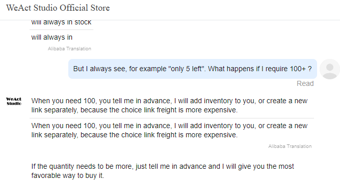

I have the Nucleo H743ZI2 but I also have several of the more compact, 100-pin WeAct modules.
On AliExpress, WeAct was only ever showing a limited availability and so I contacted them regarding future supplies:

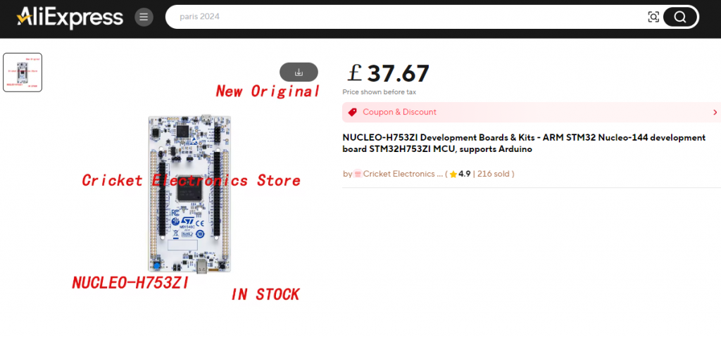

The latest Nucleo:

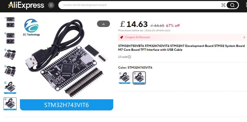

In addition to a Nucleo board (which I don't find on aliex after a brief search), I have used this H743VIT6.
Be very careful in ordering--there are many variants which won't work (insufficient memory, etc.). The "VIT6" did for me.

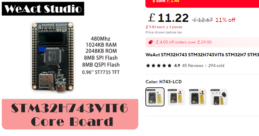

Posts: 2100
Posted: 11:58am 08 Aug 2024
The 100-pin WeAct module (again)
The other alternative is the Devebox that others appear to be copying:

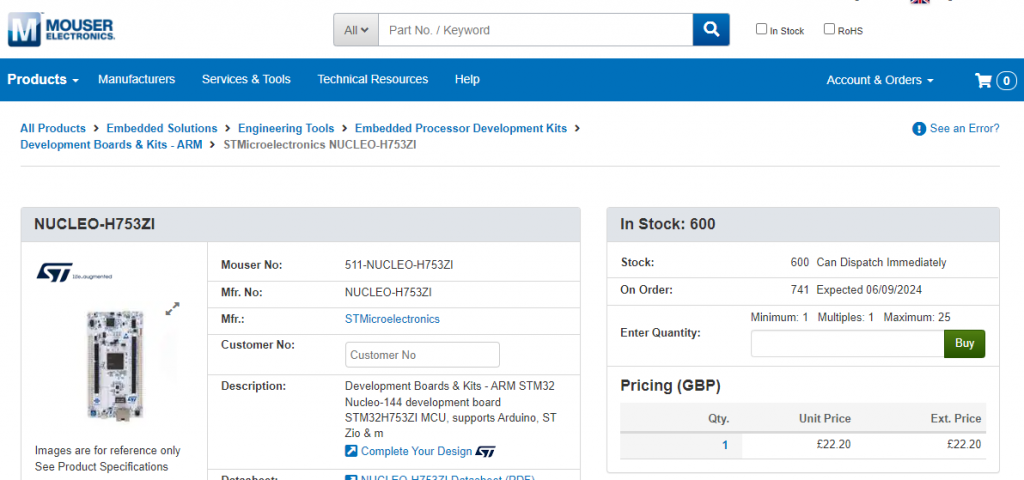

The Nucleo now features the H753ZI device. I think it was KeepIS who confirmed that it was still MMBasic compatible.
PhenixRising
Joined: 07/11/2023
Posts: 2100
Posted: 12:20pm 08 Aug 2024
In fact, the Mouser price for the new Nucleo is better than AliEx:

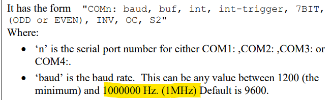

FYI:
I don't know if I have somehow missed the latest manual but mine still shows:
I have tested to 3MBAUD...The H7 won't recognize anything faster.
