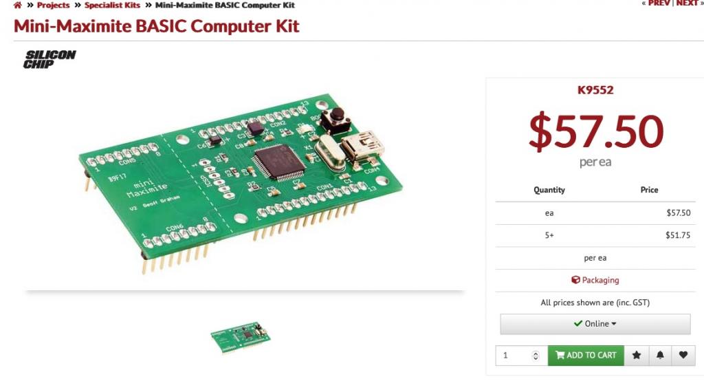

Hi does Anyone Know anything about this  Silicon Chip Mini-Maximite Basic Computer Kit
is there a design to Breakout the VGA - SD Card - power and Sound?
What if any are the Spec differences vs the CMM2?
Is it worth the risk to Spend $80 USD on one?
I really one one because my CMM2's are irreplaceable so I don't dare experiment with the GPIO and for $80 their Cheep enough for dedicated Projects

It's a cut down version of the original Mono Maximite. See
Posts: 10072
Posted: 05:56am 07 Aug 2024
I still sell the "E64" Micromite Plus module on my website here.
Scroll down a little, "MicroMite Explore 64 Version 1F - FULLY ASSEMBLED MODULE".
It is the same US$80 figure, including tracked shipping to you.
The E64 also has the built-in "Microbridge" USB interface chip, and a micro-SD card slot, which the above module does not.  (unless it's on the bottom, but I can't see that from the photo)
Regardless of if you go for the Silicon Chip module, or my E64, both are a little different to the PicoMite, in that these PIC32 based modules DO NOT support VGA.
They were designed to connect to either an SPI or parallel type LCD touch-screen.
VGA support only arrived on the Micromite Extreme(MMX) series of boards that matherp made, and I think that was only cos he ported MMBASIC to yet another chip type that COULD generate VGA.
The Mini-Maximite and the E64(and by extension, the E100) don't support VGA, so you can't use a VGA screen on these modules.
They can produce PWM sound in the same way as the PicoMite via a suitable filter.
From memory, they only support uncompressed WAV or MOD files - MP3 etc, is not supported.
EDIT: Spec differences - There are many differences, but to keep things short and simple, the Mini-MM and E64/E100 run at either 100MHz or 120MHz depending on what chip is used, the CMM2 runs at either 400MHz or 480MHz depending on if you have the revision Y or revision V ARM processor chip(so the CMM2 is MUCH faster).  The Mini-MM, E64/E100 have around 100k of RAM, the CMM2 has around 12MB depending on the SDRAM chip used.  The CMM2 supports USB keyboards, the Mini-MM/E64/E100 don't(but you can use PS/2 keyboards).  The CMM2 supports USB mice in PS/2 mode, the Mini-MM/E64/E100 don't support a mouse at all.  The CMM2 supports FAT32 and exFAT SD cards up to 128GB in size, the Mini-MM/E64/E100 only supports FAT32 and up to 32GB card size.
I'm going from my memory here, so some of that might not be QUITE right, but this is only to give you a feel for the fact that the spec differences are quite numerous, and about the only thing they all have in common, is the MMBASIC language!

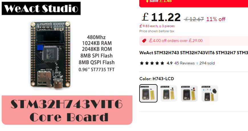

Not sure what you're looking for but the ARMmite H7 can handle 800 X 480 @ 16bits
Awesome device

I don't think it's much competition for the PicoMite at that price!
Posts: 12044
Posted: 07:18am 07 Aug 2024
  Quote  I don't think it's much competition for the PicoMite at that price!
3X as fast as a fully overclocked PicoMite, 4x RAM, much more I/O, vastly faster display output - no comparison
Edited 2024-08-07 17:19 by matherp
