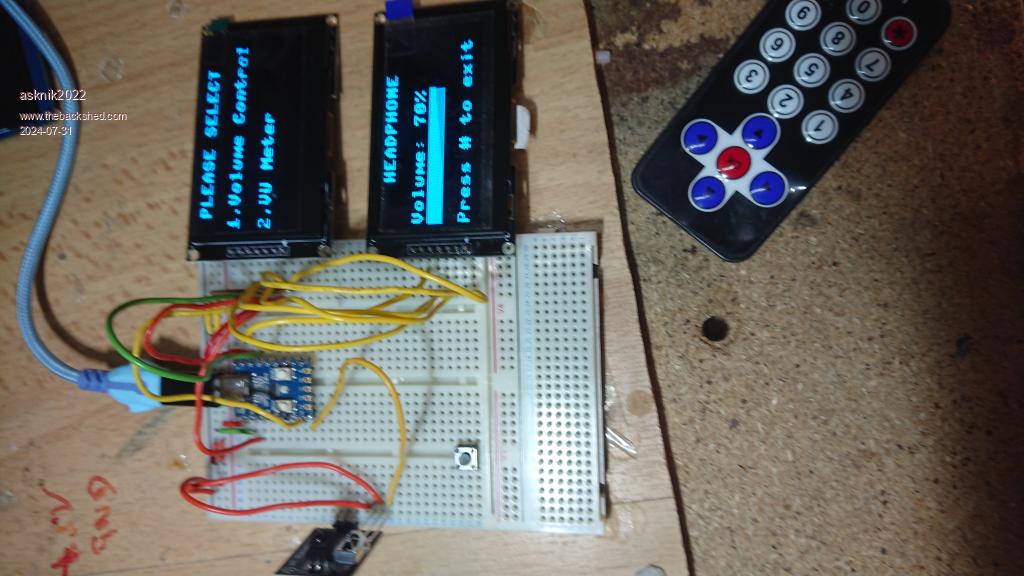

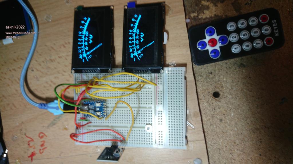

Volume + Vu Meter control in Micropython via IR
IR button 1 for volume control
IR button 2 for Vu Meter showing both Channels
IR button # to return to select screen.

Like the project ! Low wire-count for what it does.
I have forgotten how convenient the IR remote controller is,
I remember, years ago, how pleased I was to find it built into MMBasic
could I ask where you got that type with UDLR buttons ?
also, anyone, I don't think MMBasic drives SSD1309 natively ?

THis is where you can get the remote in the UK
https://www.amazon.co.uk/DollaTek-Infrared-Wireless-Control-Arduino/dp/B07DJ58XGC/ref=sr_1_5?crid=31UUFTJS4WIM3&dib=eyJ2IjoiMSJ9.UkwSJS5xAAQYwZB-zZKU6AS5o14Mqe-BaDHf6Nbw4QSXW7apUKon7PKAVhkFU__tOidKwLT-6xnwsQwPw-DQ8R0dXiUWYvC0cUOnClluNu_XM1YeYjHL-lcBfVqkoLhxAlw_9ucYc6v7rB4xgmkGSH0w7olIpNpLCrw-aa3a_p5dhfmdDVHRLAEsWSIEj4ALptItv6Ex-LPsaVPT9jdAbdCTZvJZJoi1fD3a_BDSbaQ.ww-1okaIPwXT8pfYxsBECbnTuG8eXv4cHjgEAofxyoA&dib_tag=se&keywords=IR+%2B+Remote&qid=1722409745&sprefix=ir+%2B+remote%2Caps%2C125&sr=8-5
I had to write this in Micropython because MMBasic doesn't suppport the SSD1309
Is anyone wants the code then let me know.

AFAIK MMBasic if not feaured driving dual displays anyway. There may be tricks around it, but default is 1 display.
Vice project by the way. The VU meters look quite good for the limitted resolution.
