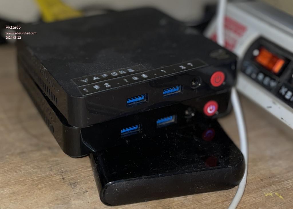

Hey man I LOVE my Mini Pc's I've got 4 of them strewn through out the house and as soon as I can get s customer upgrade I'll have 4 more ;)  I love them because they only raise my Power bill like $2-$3 a month I'm running Ubuntu on 2 of them and win 11 with Win 10 - 11 HACK! one of my Ubuntu boxes is running the NAS in my Living room, 1 of the win 11 boxes is running my vinyl cutter, the other 2 boxes are on my desk, and all of them are headless and running Microsoft Remote Desktop I really like having the 2 on my desktop as sand boxes so I Don't screw up my real Workstations with trying something new or micro$oft patches.
Oh and I'm with you about the Proving I'm Human, I have moral Objections to lying to the computer that I am Human when Clearly I'm not

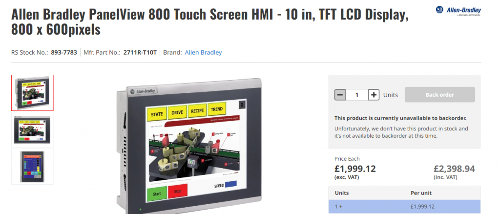

By far, the biggest reason for industrial machine downtime is a dead HMI. For me, it's a good thing because it's how I make a living
I also have hundreds of machines in the field with a PC-based control and for the most part, they are reliable but when they fail, it's usually a pain to recover from.
So today, it's microcontrollers for the real-time stuff and an industrial Android tablet for the front-end with a Bluetooth link. No config necessary, simply download an app and we're off to the races.
We have all kinds of display options for our Mites but why bother? What if a screen breaks or touchscreen fails? Most of us carry the most powerful user-interface ever created on our person.
Purchase price can be painful enough but that's nothing when there won't be any in stock for several weeks and the production line is dead-in-the-water:
