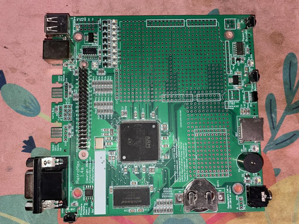

My RTC Batteries are dead in both my CMMs, I took a break from Everything for a while and am trying to get back at it, anyway Neither battery has leaked yet,  so I Pulled Them! Any thoughts on playing with them with our batteries?   Any thoughts about long term damage if I don't replace them?

It'll almost certainly be fine without the battery, however if you set the time and/or date it'll be lost as soon as you lose power. If there is anything in the RTC memory that will go too as it is battery-maintained CMOS.
I've never heard of any RTC that is damaged by not having a battery, no matter how long you use it for. After all, it's safe with a flat battery. :)

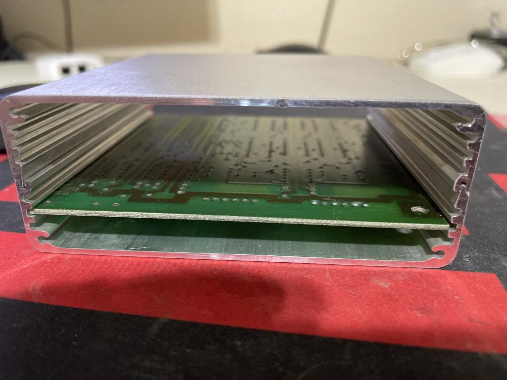

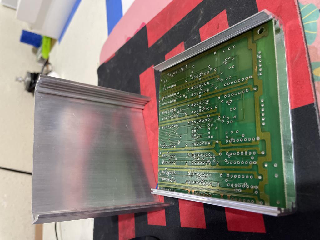

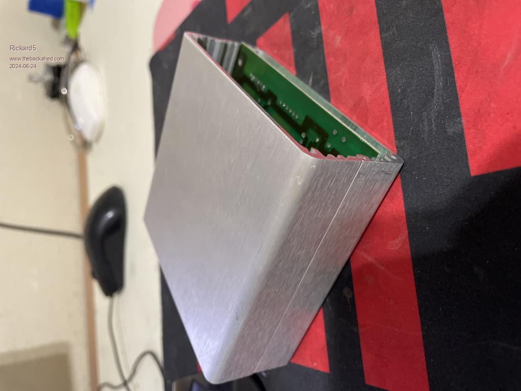

Gizmo, I picked up one of them Cheep 3018 desktop CNC mill / routers on Bangood when they were on sale for $100, then open 100s hours and incalculable favors and Love in trade with some of my machinist friends making it useable ;)
Mainly because I met this Gal years ago that worked at Kiser Aluminum where they Extruded the Shapes that make Killer Project cases, and she got me a life time supply of cutoff drops in all sizes and shapes, I got a few left I make my fece platers from the 3 layer sign plastic is I can cutout and engrave labels The SAD SAD thing is the Kiser plant here is gone so what I got is all there will be.
I'll send you my DXFs when I stop being lazy and get them done
one more Question my power button its laid back like 30 degrees is this on purpose or have I damaged it? it still works, I'm just wondering if I should spend the $$$ to have one of the Rework girls to straighten it out?
CircuitGizmos
Joined: 08/09/2011
Posts: 1427
Posted: 07:31pm 23 Jun 2024
1) I need to date better women...
2) The button should be 90°
