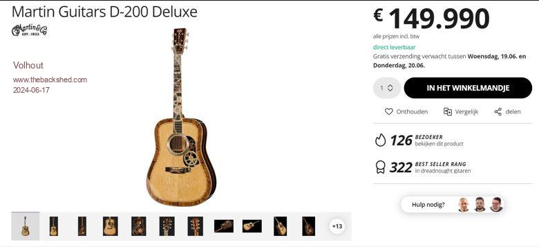

I was confused. Buy a Martin&Co guitar for 58gbp ?
But then I read "MartinSmith". Ok .. different brand....
PhenixRising
Joined: 07/11/2023
Posts: 2100
Posted: 09:06am 17 Jun 2024
@Volhout
150K for a lump of wood with strings on it????
I'm definitely in the wrong business
I see a lot of £2,000 Martins at open-mic gigs and owners who can barely play.
They all have the aforementioned piezo pickups and sound thin and tinny but they seem to believe that they spent the money and therefore they must be sounding good.

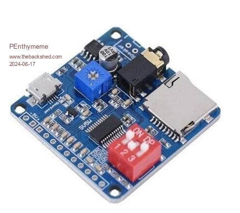

I bought one of these: https://www.amazon.co.uk/dp/B0CM47X42Q?psc=1&ref=ppx_yo2ov_dt_b_product_details
It has a few modes:
* It can trigger specific MP3s when pins are grounded (they way I use it)
* It can trigger specific MP3s and which part using UART mode
* (I think) it can also be controlled by SPI
PDF data sheet..
DY-SV5W Voice Playback Module Datasheet.pdf
My use case is a ghetto sound board linked to PicoMite.
Px

  PEnthymeme said  I bought one of these:
Oh this is soooo cool    and has given me another idea.
I can get four of them for ~£10 on AE
Using the PicoMite to control them, I bet I could have a multi-track playback device.
I might have backing bass on one channel and percussion on another (and then something else on the other tracks) which would allow me to set levels to suit a particular venue. I already have a mini-mixer. I bet that they would stay in-sync at least for the duration of a song(?)

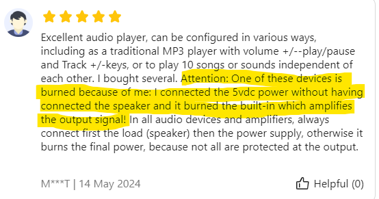

PhenixRising
Joined: 07/11/2023
Posts: 2100
Posted: 02:58pm 17 Jun 2024
Surely not?
Posts: 9230
Posted: 03:15pm 17 Jun 2024
Unusual nowadays. There have been circuits that did that, but not for many years that I know of. However, what you might not be able to do is to connect the speaker from one side of a differential output to ground. The output has to be between the diff outputs of a bridged output as there may not be an isolation capacitor.
PhenixRising
Joined: 07/11/2023
Posts: 2100
Posted: 04:05pm 17 Jun 2024
  Mixtel90 said  Unusual nowadays. There have been circuits that did that, but not for many years that I know of.
My thoughts exactly
