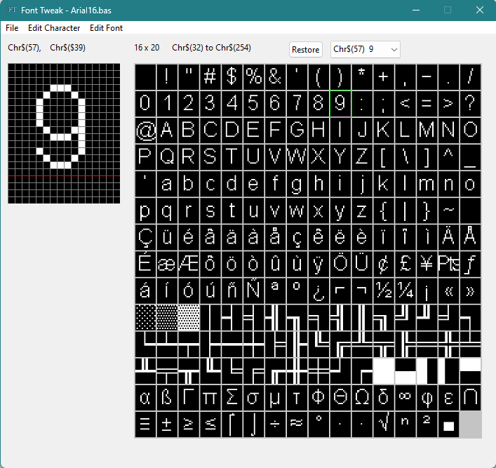

I have been playing with FontForge on another project and decided that it does a much better job of converting TTF to bitmaps than FontTweak.
I export the bitmaps from FontForge as a Microfoft style .fnt file and import into FontTweak.
There are a few steps but they are hopefully clear enough in the FontTweak help file.
The ZIP includes the exe and help file

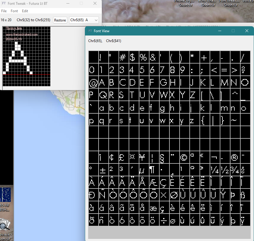

I have joined the font view and character view windows together. It makes life easier.
I just need a few days to finish the Linux version before releasing the update.
