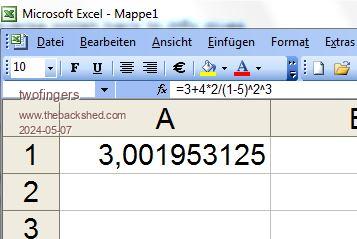

  matherp said  3 + 4 * 2 / ( 1 - 5 ) ^ 2 ^ 3
is calculated by MMbasic as 3.001953125
UPDATE Wolfram Alpha also gives 3.00012207 so I suspect MMbasic is wrong
But that's what Excel says:
strange ...

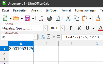

homa
Joined: 05/11/2021
Posts: 719
Posted: 03:37pm 06 May 2024
Very interesting, thank you!
  NPHighview said
PEMDAS is one attempt to implement the arithmetic concept of associativity. Here's an excellent explanation of how that is (or isn't) implemented in various programming languages, Excel, Matlab, Wolfram Alpha, etc.
and Libre ...
Matthias

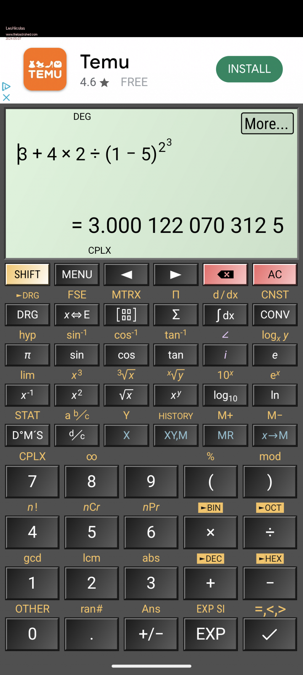

Posted: 09:47pm 06 May 2024
From the android app HiPER Scientific Calculator

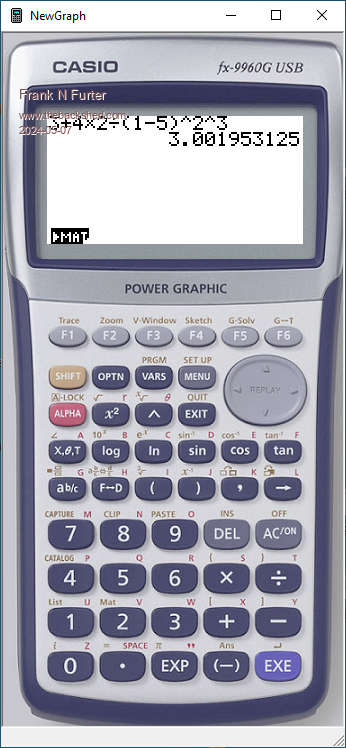

Posts: 1156
Posted: 06:26am 07 May 2024
This is what my CASIO calculator shows:
Frank
