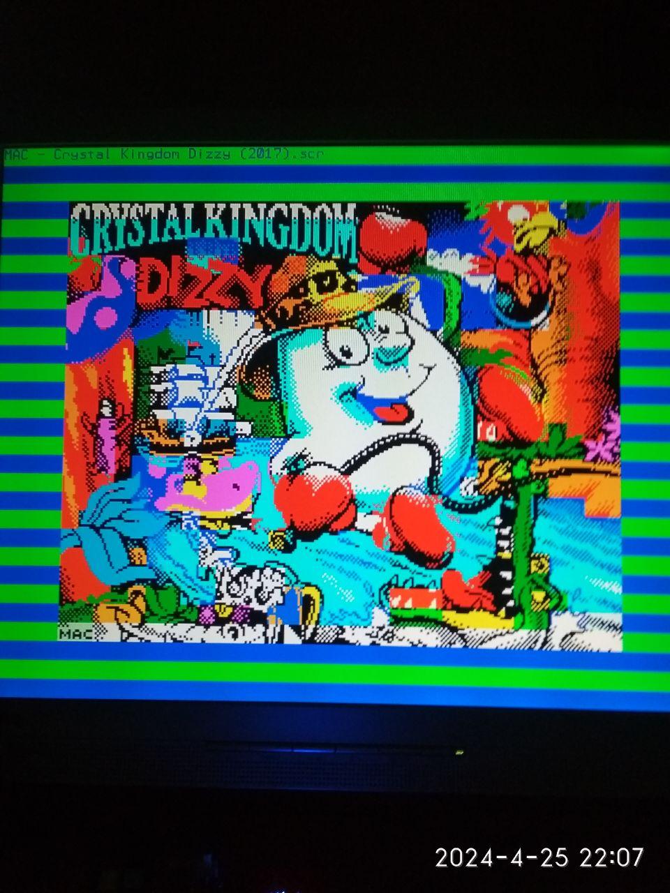

MMBASIC Photo frame for ZX Spectrum screens on PicoMiteVGA
MODE1 - Monochrome 640x480 mode + color TILE
ZXSCREENER.ZIP
Download files for ZX-Spectrum screens in *.scr format can be downloaded from the website:
https://zxart.ee/

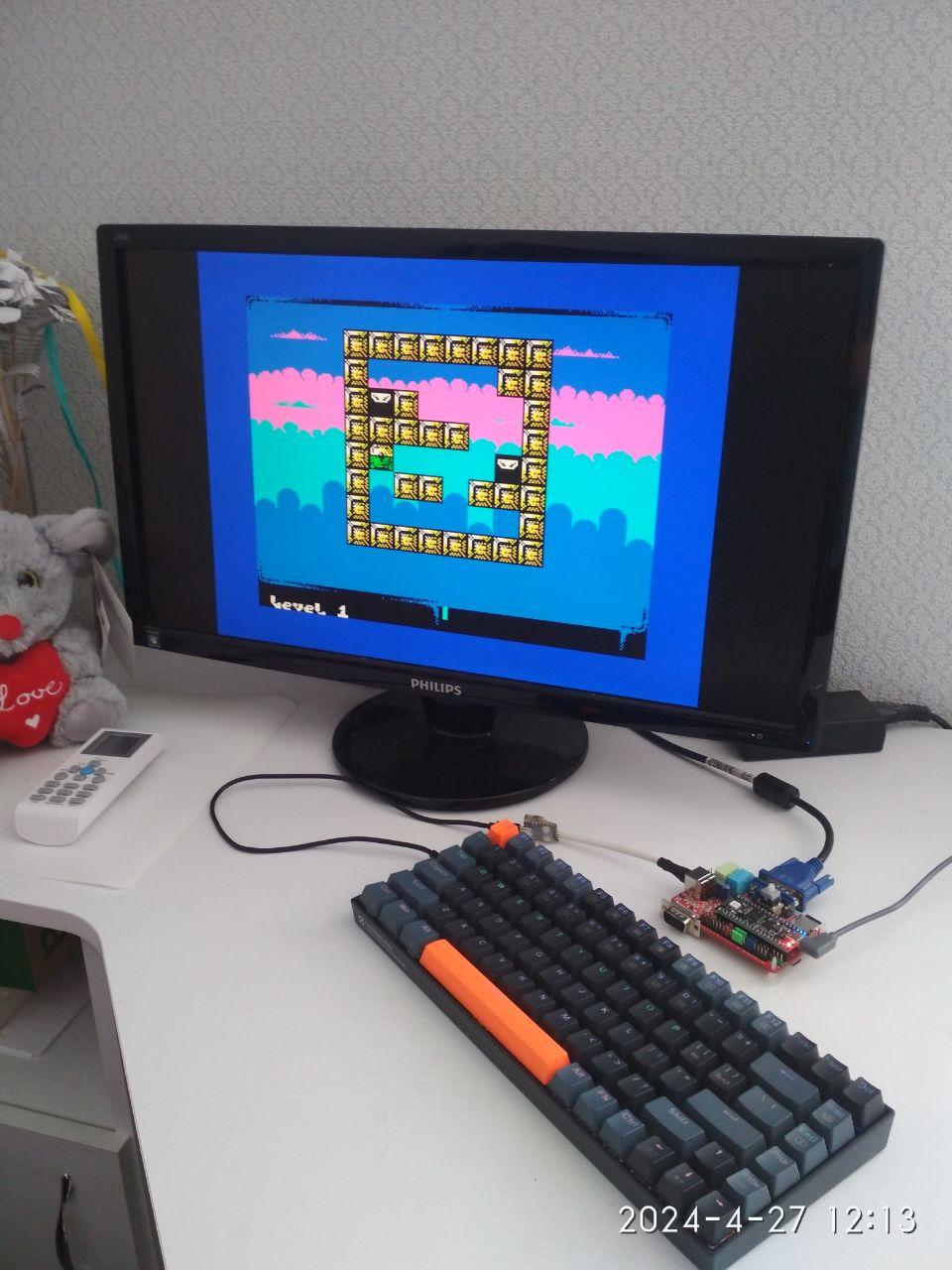

Nice keyboard.....
Amnesie
Joined: 30/06/2020
Posts: 763
Posted: 10:22pm 27 Apr 2024
Haha... honestly I just wanted to say the same as Volhout
REALLY cool keyboard
Greetings
Daniel
Posts: 9230
Posted: 07:17am 28 Apr 2024
This one on AliExpress looks very similar.

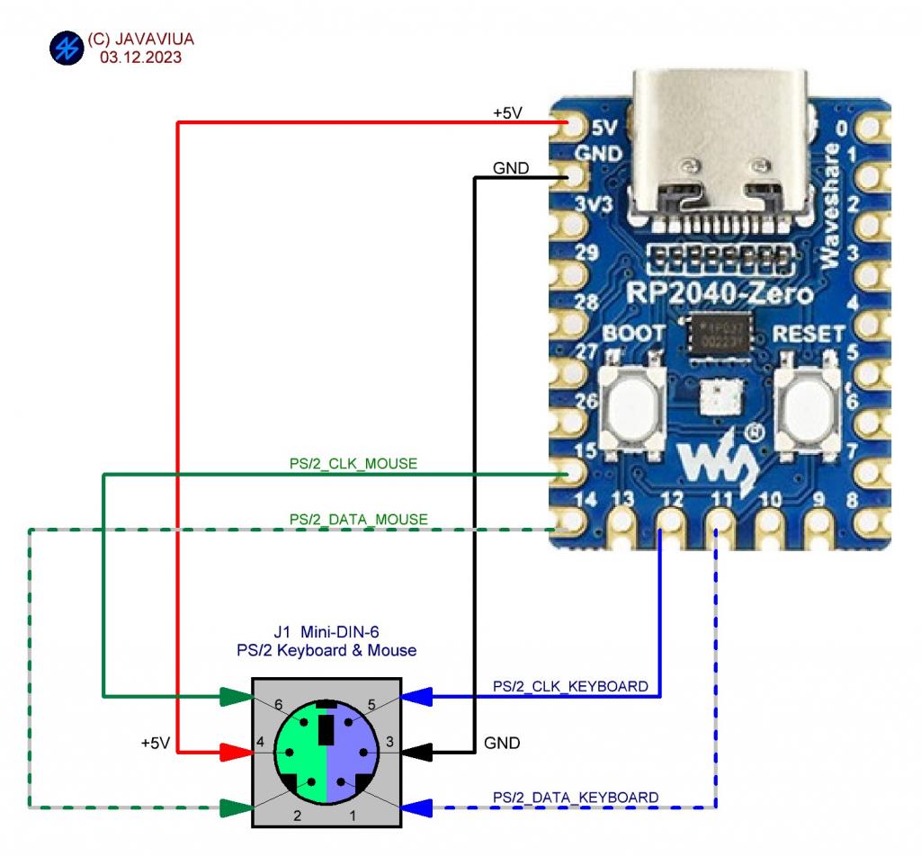

Is that a home made USB C to PS/2 adaptor for that keyboard?
javavi
Joined: 01/10/2023
Location: Ukraine
Posts: 621
Posted: 06:26am 05 May 2024
  Hawk said  Is that a home made USB C to PS/2 adaptor for that keyboard?
Hi, Hawk
Yes, this is an adapter from USB to PS/2 keyboard and mouse
https://github.com/No0ne/ps2x2pico
For PicoMite it will work in a minimal circuit version.
Edited 2024-05-05 16:30 by javavi
