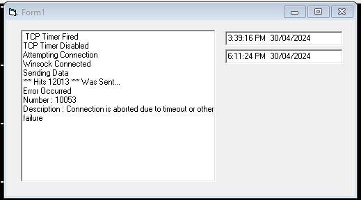

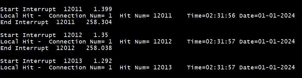

I re-wrote the vb code because the error trapping in the previous version was a bit non-existent. It's much better now
I ran the vb code and the WM code tonight when I got home from work. Here's the results:
12013 hits to the WM from VB code at 500mS intervals over approximately 2 1/2 hours until it trapped a fault.
The VB code process list as printed to a text box that shows each stage as it happens (Top line on the right is start time, bottom line is the fault time, and 'Number' is the WinSock error number...) -
This is the print to MMCC...
Which shows that the WM received the data, but couldn't (or wasn't able to) respond.
The VB connection is/was still open, so it was waiting for a reply, but for some reason the WM got stuck inside a brain-freeze and couldn't send the data out.
