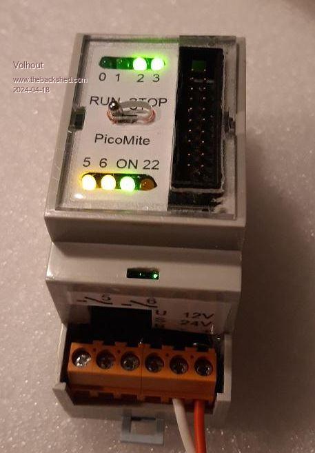

Hi Malibu,
Look here:
MMbasic PLC based on PicoMite

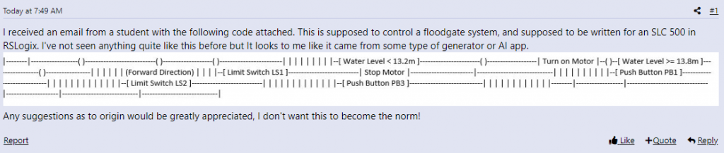

So this is an example from those who turn their noses up at we and our "toy language":
Pretty obvious that the text-file is missing its CRs and LFs, right?
"Doesn't look right because nobody puts coils in series"
"Looks like it might've been AI generated"
Give me strength

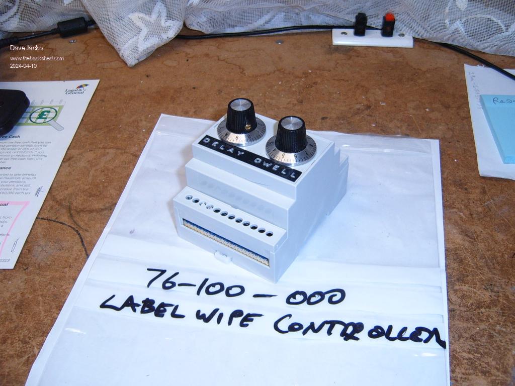

I found this to be a useful and sensibly-priced enclosure.
Known as D4MG Din rail enclosure, MC001143 from Farnell
similar is CNMB/4  or  CNMB/4/KIT from Rapidonline mfr CamdenBoss
This has a PIC16f1825 in it, but a PicoMite zero would have done the job better.
Just a piece of stripboard and some pcb mount screw terminals. Voila, a PLC!
Try swapping 2 and 3 over

Posted: 07:24am 19 Apr 2024
EDIT: deleted...
It looks AI generated at second view.
