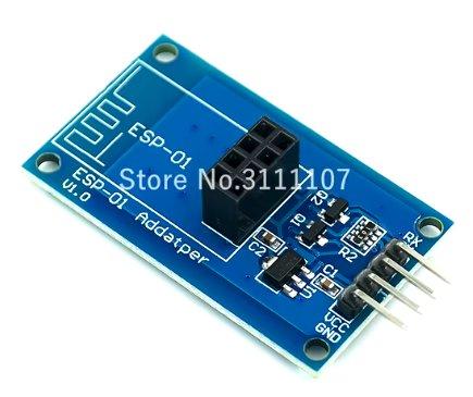

Having just received a CMM2 board from Vegipete, I might try an ESP-01. I did try it with Mick's PicoMite backpack but there is a difference between the ESP-01 and the ESP-01S in that the first requires a pullup resistor on the enable to 3.3V to even work in one of the USB adaptors for the PC. I used the ESP-01S in the picomite backpack but have added the resistor to one of my ESP-01 units and on the other I added it to the dongle. I only tried it using the AT command set but haven't really used it on the Backpack. Other than that I can't comment further.

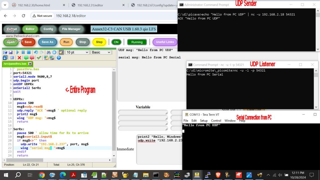

If your use is not commercial, why not use Annex Basic?
Home page: Annex Basic
Web Flasher: Browser-based installer
Forum: https://cicciocb.com/forum
Easy to flash any variety of ESP from your browser. Then when connected, you have a browser-based editor and run/debug environment with a programming language which will be familiar. If all you want to do is send and receive messages, this is easily done with not very many lines of code, and you have the choice of UDP, ESP-Now, MQTT, serial, and email.

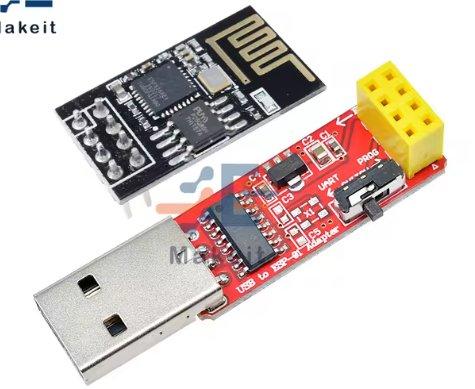

For the ESP-01S (which has no USB), I flash with this adaptor:
For Firmware Flashing
Easy to connect via serial with this adaptor:
Serial Adaptor
