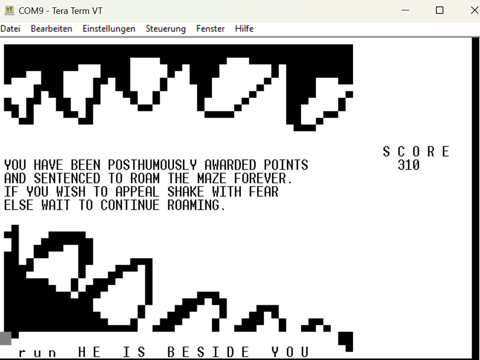

What was planned as a small project for over the Easter holidays ended up taking even longer.
But now, here is :
a playable Version of ZX81 Classic 3D Monster Maze for PicoMite, Running in a VT100 Terminal (TeraTerm)

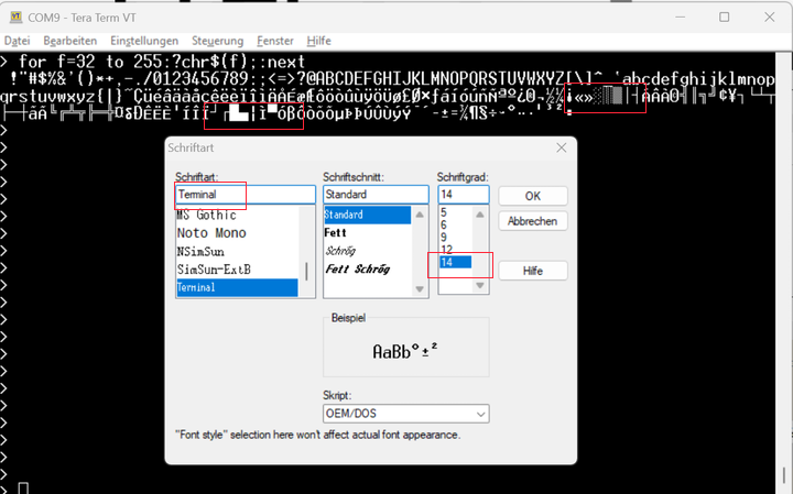

For the correct representation, pay attention that your terminal program uses a font that contains the graphic symbols in the range above 128.
Especially CHR 176-178, 219, 220 and 223 are important here.
I Use a Font called TERMINAL

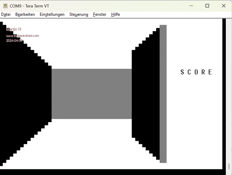

so here we have the PicoMite VGA Version
3DMonsterMazeVGA.zip
runs on VGA, Game*Mite and MMB4W
Game*Mite controlls are not implemented jet
It uses a resolution of 256x192 pixels because I couldn't find a way to implement a 10x10 Pixel font in MMBasic.

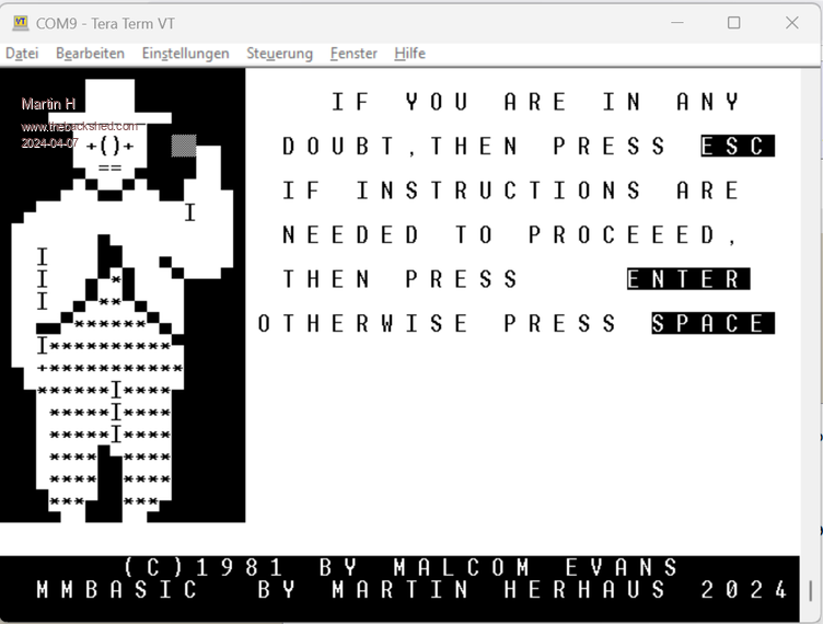

Here is the cleaned multi-platform version
3dMonsterm1.zip
Supported systems:
PicoMiteVGA
Game*Mite
MMBasic 4 Windows
for a pure PicoMite continue to use the VT Terminal version from the beginning of this post
Game*Mite Controlls are included:
A/Start = Enter instructions
B/Down  = Space
Select  = Escape
direction buttons  Navigateion
have a nice Weekend
Martin
