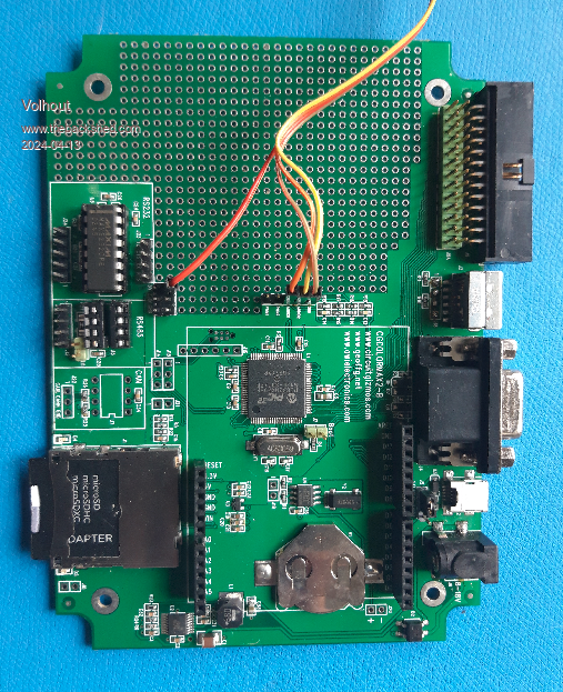

Posted: 07:31am 13 Apr 2024
Hi Phenix,
You are not the first to confuse the GCCOLORMAX2 with a COLOR MAXIMITE 2.
But here it is, in all it's glory...
As with your PID algorithm, the output most likely is send to a PWM that controls an H bridge and drives a DC motor. In case of a stepper motor you have to drive the coils in software. If you have a 400 steps per revolution motor, and you want to drive it at 30 rpm, you have to control the coils at 800 pulses per second. And when you get close to it's maximum speed, your timing must be accurate, otherwise it misses steps.
Typical stepper motor applications do not have feedback in form of an encoder. So missing steps is deadly. But no feedback means...no PID. There is only forward control. That is why DC motors have taken over, using encoders.
It was my suggestion to avoid the real time (creating time accurate step pulses) from the relatively slow CGCOLORMAX2, and have an arduino/pico with dedicates control software control the motor. So you only have to send coordinates and commands from the COLORMAX.
But -all in all- Allie is not responding anymore. I fear we are only brainstorming, and he lost interest. Let's stop this until there is a sign of interest from his side.

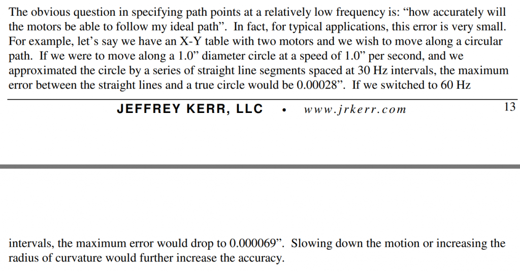

When interpolating between low-frequency path-points:
