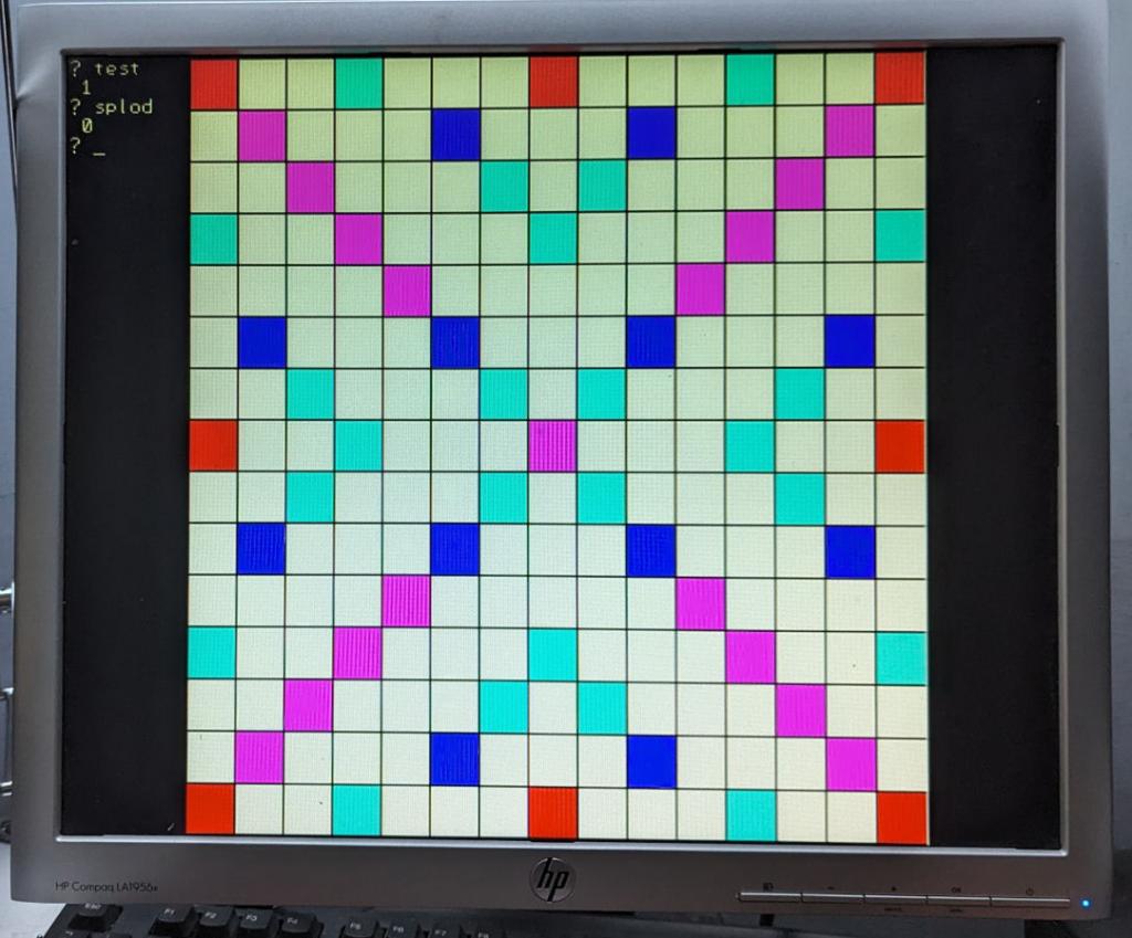

Since Scrabble is in the news at the moment I thought I'd have a go at developing a version for the PicoMiteVGA
This will be a significant development - anyone interested?
At the moment I have drawn a board, loaded and indexed a dictionary and built a function for testing a word against the dictionary
To run the code you will need PicoMiteVGA V5.09.00RC4 running on a Pico with at least a 4Mb flash memory running as fast as you can get it.
PicoMiteVGAV5.09.00RC4.zip
and you will need to set up a very large modbuffer able to hold 2707014 characters. i.e.  OPTION MODBUFF ENABLE 2644
RC4 includes a couple of tweaks to make this all work:
FLASH MODBUFF LOAD fname$
MM.INFO(MODBUFF ADDRESS)
Attached below is the dictionary file which should be copied to the B: drive
sowpods.zip
The first time you run the program it will copy the dictionary into the modbuffer and build an index into the dictionary - this takes a long time. It will then draw a scrabble board on the screen and enter a loop asking for words which it then tests against the dictionary - that's all at the moment

Edited 2024-04-10 04:00 by matherp
Posts: 6192
Posted: 06:51am 10 Apr 2024
Hi Peter,
It is a nice board, drawn in mode 1, should be workable. To make the game 2 player with dictionary checking seems a relatively simple task from here. But to play against the pico (the AI) is a different cooky.
When generating the index already takes significant time, finding just any word that fits on a certain location on the board will be similar to worse(*). And then find the best word (most points) is factors slower. And then expand that to "any word, anywhere on the board".
I do not think this is something for me. Too complex.
(*) let's assume there is an "A" the board on location (5,5). You no only have to process all words that start with "A" in 2 directions, but also second letter (so the "xA" words in 2 directions. And these are indexed. But also all words in the dictionary that have the "A" as the third letter, or the 4'th. And it gets insanely more work when there is a "D" in location (7,5). The rules to do this are pretty simple, and for each word you can calculate the value, and decide for the best. But it will be very time consuming. Actually... if you look what you will have to do for the AI, I think the indexing won't help at all. The indexing will be usefull to decide quickly that the word typed in by the human, is approved.
