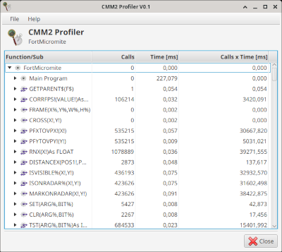

Hello,
Some time ago I discovered that the CMM2 has a built-in profiler, which you can activate by typing "option profiling on" at the basic prompt.
I found this feature quite facinating so I tried to use it to optimize my games. Unfortunately the CSV output is not really human friendly and the advice from the manual to use Excel for the analysis is quite time consuming.
Therefore I wrote a small tool in Java (running on Windows and Linux) called CMM2Profiler, that makes life a bit easier here.
You can load a profiler log and do some basic analaysis. Screenshot below.
The source code is on GitHub but for all who don't want to compile the java code, I put a precompiled version in the GitHub Wiki:
  https://github.com/grimm-git/CMM2Profiler/wiki.

  joker said  Hello,
Best Regards
 Matthias
Thank you for a very useful utility!
Might I suggest giving the user the ability to sort on the different columns? I know I'd like to see the last column (Calls x Time) in decreasing order so I could determine the biggest "offenders" at a glance.
joker
Joined: 06/02/2024
Posts: 54
Posted: 07:33pm 11 Apr 2024
Yes, you might
But it is already built in.
Just click on the column headers until you get the sort order you prefer.
Best Regards
 Matthias
