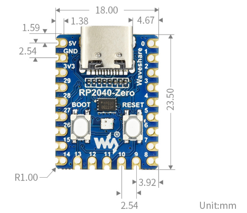

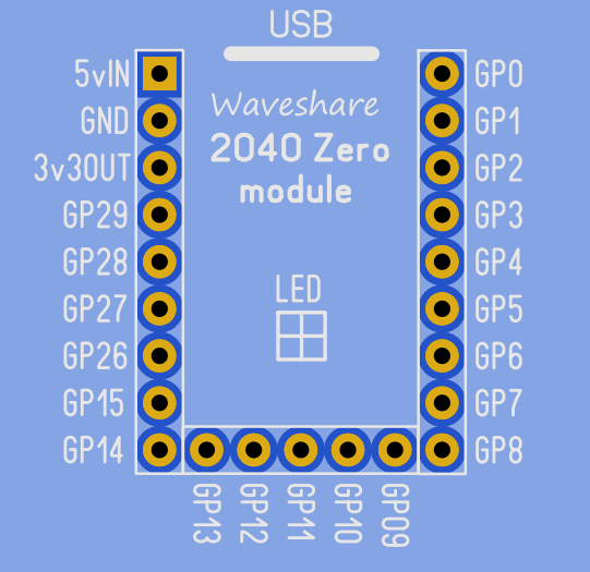

I have Grogster-Graeme's but it doesn't seem to jibe with what I see on the Waveshare 2040-Zero datasheet. Is there more than one design?
Posts: 9230
Posted: 11:06am 28 Mar 2024
Mine are almost like your photo, although they are not Waveshare branded. Note that the bottom row from 14 down to 8 are all on 2.54mm centres and that you can't easily surface mount this board as the RP2040 is mounted on the bottom.

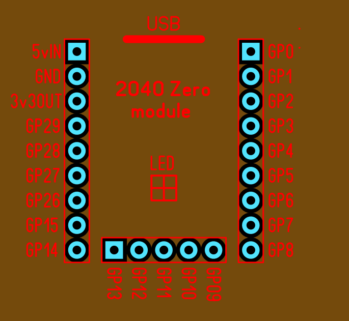

Thanks Mick, I was sure that you had one because it was the Sweetie-Pi that made me look at Grogster's macro.
I modified his to this (which I think is the same as yours). Grogster's has different spacing between the side-holes and the bottom row:
This is all 2.54mm. Should be good, right?
Posts: 9230
Posted: 12:04pm 28 Mar 2024
Should be fine, yep.
Posts: 10072
Posted: 09:48pm 28 Mar 2024
Hi - that first image looks like it was not quite right, and as you say - does not really fit the module.  I suspect it made it into the makroes pack, as an early one, cos the correct one is the modified one, and yes - all on 2.54mm grid, but not suitable for breadboard mounting unless you leave the 5-pin header off.

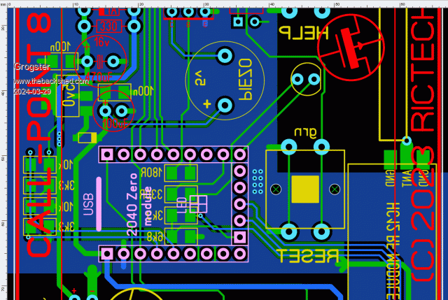

An example of my use of the module on a board:
Posts: 9230
Posted: 10:28pm 28 Mar 2024
I managed to design a I2C game controller using one surface mounted, by cutting a notch out of the pcb and having the solder pads round the edges of the notch. It looks like it would work well, but you can't have components or tacks underneath it of course.
