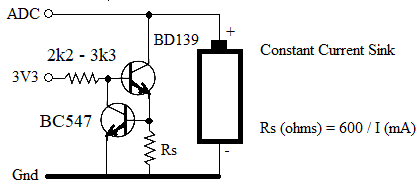

For a local "maker club" (with adults / children) I want to build a "simple" battery tester to test the capacity of single AA batteries.  The idea is to test various brands, including rechargeable, capture voltage over time and use the data for discussion.  Current can then for each sample be calculated I=V/R -- this allows the mAh capacity of the battery to be calculated.  But as the voltage and hence the current is changing for each sample, the calculation is not totally trivial.
Constant load is as simple as some resistors in parallel plus one in series to limit the current to the GPIO pin.  This works as you would expect and voltage/time can be captured.
I want to extend this either as an option in the software or via a different build to have a "constant current" mode.
Options using transistors / op-amps all seem to require additional power (I want to keep this as "simple" as possible - both for the build and for the explanation.
My current (pun not intended) thinking is to use different arrays of load resistors and swtich them in/out as the voltage drops to give some semblance of constant current.  I seem to recall this being on the forum before -- but searching hasn't helped.  Any one remember this?
OR - is there a "better" solution?  (I want to limit this to testing just x1 AA and power from the Pico itself (no 9V batteries etc). Ideally any additional transistors will at best take 0.6V from the battery so when the battery discharges below 0.9V this will stop functioning.

ADC input -----------+--------------------------+
    3V3  _________|/   NPN                     |
                  |\e                          +
                    |                         BATT
                    | 2V7 @ required current   -
                   | |  27R = 100mA            |
                   | |   9R = 300mA            |
   GND -------------+--------------------------+
Might work...  :)
You could also connect the base to a couple of forward-biased silicon diodes in series  fed from a resistor from 3V3 at about 3mA. That would give a reference voltage of about 1V2. The emitter voltage would then be about 0.6V at your chosen current. This would be much better for single cell testing. Resistor values would need to be selected on test, I think, but should be applicable when using the same types of diodes and transistors.
Edited 2024-03-25 00:01 by Mixtel90

OK - will have a tinker.
Forgive my lack of "transistor" knowledge here...
I see how this will limit the current to that set by the resistors.  As the battery discharges this will set the upper bounds of the current draw.  When the battery discharges, and its voltage is insufficient to drive 100mA any more, at that point to current will fall?  So if I sense the 2V7 on another pin, when it falls - the test ends?
Seems doable and simple.

Not easy to get a constant current sink down to 0.9V (a typical cell end point voltage) without using an external supply for the reference.
A NPN transistor such as a BC337 will lose about 0.6V across it when saturated. That only allows 0.3V at the emitter and therefore 0.9V on the base as a reference voltage. That's under ideal conditions.
The lowest easily obtainable reference voltage is 1V2 (use a variable voltage reg but ground the ADJ pin), which would give 0.6V at the emitter and 1V2 minimum at the collector.
After that you are in the realm of op-amps and external supplies.
Posts: 3414
Posted: 12:49pm 25 Mar 2024
This may be worth a try.
A small heatsink on the BD139 may be needed.
Decrease the base resistor to 560Ω to 1kΩ to get Vce down to 0.3V
That will give get the cell down to 0.9V before the current tapers off.
Edited 2024-03-25 22:56 by phil99

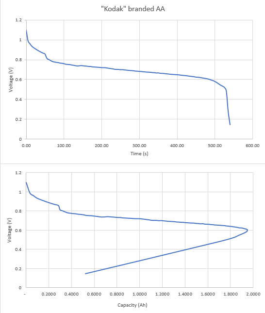

I built a simple constant load with x4 10k resistors in parallel (heat dissipation) - giving 2.5 ohm.  And a 4k7 into the Pico.
Leaving it running overnight gave this.
From asking my resident 19yo the voltage / time graph is "easier" to read and she used it to estimate the "life" of the battery at just over 500 minutes - 525 was her "guesstimate".
But battery "capacity" is given in mAh - so we calculated that from the data (second chart) - and you can see that this peaks at just shy of 2000mAh (1950mAh from the data) - this occured at 485 minutes, just as the first chart goes non linear.
Interestingly Kodak (or whoever actually makes them) produces a data sheet for these batteries and they claim "2800 mAh at 75 Ohms to 0.8 Volts".
Ours "failed" at 1950mAh at 0.6V.   However, the resistance was less, current higher in our case.  But still, quite a bit different.

An apparent reduction in Ah capacity at higher discharge rates is normal for most battery types as the active material is used less efficiently. Also the internal resistance drops more voltage at higher current, so you reach the end point earlier.
Especially for carbon - zinc. As it discharges at higher current hydrogen is produced on one electrode (I forget which), creating an opposing voltage that reduces the terminal voltage. Adding insult to injury, it also raises the internal resistance. Over time the manganese dioxide absorbs the hydrogen and capacity rebounds.
If you test it again the next day, at lower current there is still some useful life.
