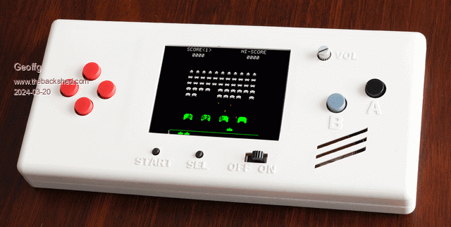

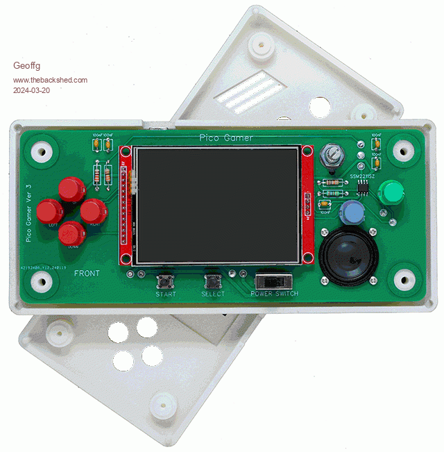

The April issue of Silicon Chip magazine is hitting the streets about now and it features the Pico Gamer.  This is a game playing console similar to the Nintendo Game Boy Advance but using the PicoMite.
It is based on thwill’s concept for the Game*Mite but with a 3D printed case, a different circuit and different firmware.  It is however software compatible, so games written for the Game*Mite will run unchanged on the Pico Gamer and vice versa.  The default firmware comes with most games available on the Game*Mite (with the authors' permission) plus my versions of Pac Man and Tetris.  Adding more games is easy, just copy them to the PicoMite’s drive A: and they will immediately appear in the menu.
An important component is the 3D printed case which can be made by many companies in China, typically costing less than US$20.  The case has a smooth rounded feel which sits well in the hands but it’s most important feature is that it holds the switch buttons steady – without this buttons have too much side to side “wobble” which ruins the game playing experience.  The design files are on my website ready to be sent to China.
A full description plus all the construction data and firmware is on my website at: http://geoffg.net/picogamer.html.
You can watch a short video describing the Pico Gamer here: https://youtu.be/Koi4JSnmtNg
Silicon Chip has made a video demonstrating the games: https://www.siliconchip.com.au/Videos/
Silicon Chip is selling full kits plus some components (PCB, case, etc) here: https://www.siliconchip.com.au/Shop/?article=16207
If you are going to build it you should also consider purchasing an electronic copy of the April magazine (AU$10) as it goes into more detail.  The online and downloadable versions of the April issue will be available from 28th March here: https://www.siliconchip.com.au/
I have a web page describing the design of the 3D printed case here: http://geoffg.net/3D_Printed_Cases.html
Credit to thwill for thinking up the Game*Mite.  It is a great concept.

Congratulations wit the new Pico Gamer !!
I looks very nice. And a good thing that you could keep it compatible with the Game*Mite. That will definitly help with growing a larger game base.
I also read your text about designing the case. That is something on my wish list for the comming year.

Looks great - congrats!
Posts: 4405
Posted: 09:47am 20 Mar 2024
Very pretty.

The thing that surprised me about the commercial Stereolithography (SLA) process was how perfectly smooth the finish was, no "lot of sanding and finishing" was required.  The result was also quite strong with no warping.  And this was for something that cost just US$17.50 for a one off print run.
Creating a 3D design does not require any special skills.  You start with a solid cube and then cut holes, extrude parts, bevel corners, etc until you get what you want.  The complex part is learning the software package but I would rate it as similar to the effort required when I first used a PCB design app.
I too grew up bending aluminium to make enclosures and for something like a PicoMite VGA design an ordinary plastic box is fine.  But the Pico Gamer demanded something much more sophisticated.
Now that I have put the time into learning the Blender app I'm going to be using more custom boxes... it is so easy.

Just one comment on your website article
You state that the firmware can be upgraded. But 5.09 causes a complete reset of the flash (and has to) so the A: drive will be cleared. Tom has a mechanism of rebuilding the Game*Mite from the source programs. You may need something similar as new games may start to rely on 5.09 capabilities. Otherwise users will be locked into an older version of the firmware.

@ Geoff
Is it possible to have a version of the lid with the lettering either recessed into the top or omitted altogether rather than sitting out proud so it can be printed face down flat with a standard printer if desired.
Your comments on printing rounded corners etc lead me to search & then find this for OpenSCAD.
Got it working OK on a test box.
Brian

Posted: 01:19am 21 Mar 2024
  Chopperp said  @ Geoff
Brian
I was going to suggest OpenSCAD. You can easily import Geoffg's STL files (thanks for providing them Geoff!) and then remove the printing.
